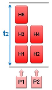

Now assume that we have changed the system and have a 5th partition but still have our 2 workers P1 and P2. The time it takes is actually 50% more assuming the 5th partition has the same size as the original H1 – H4 partitions.
Time_example_5parts
In other words to scan these 5 partitions, the time t2 it takes is not 1/5th more expensive, it is a lot more expensive and some other join plans may now start to look exciting to the optimizer. Just to post the disclaimer, it is not as simple as I state it here, but you get the idea on how much more expensive this plan may now look…
