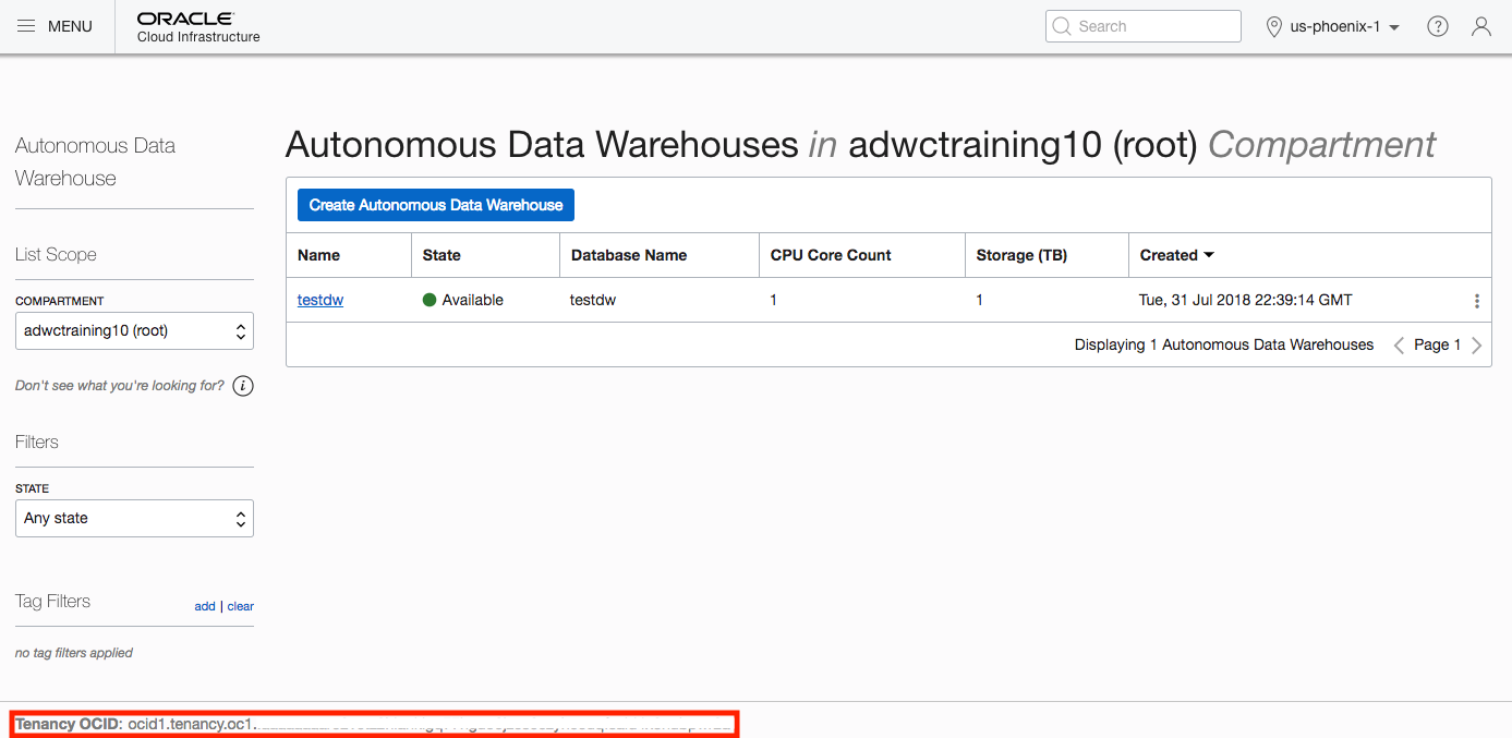

Tenancy ID
The first one is the tenancy ID. You can find your tenancy ID at the bottom of any page in the OCI web interface as indicated in this screenshot.
Copy and paste the tenancy ID into the tenancyID argument in your oci-curl shell script.

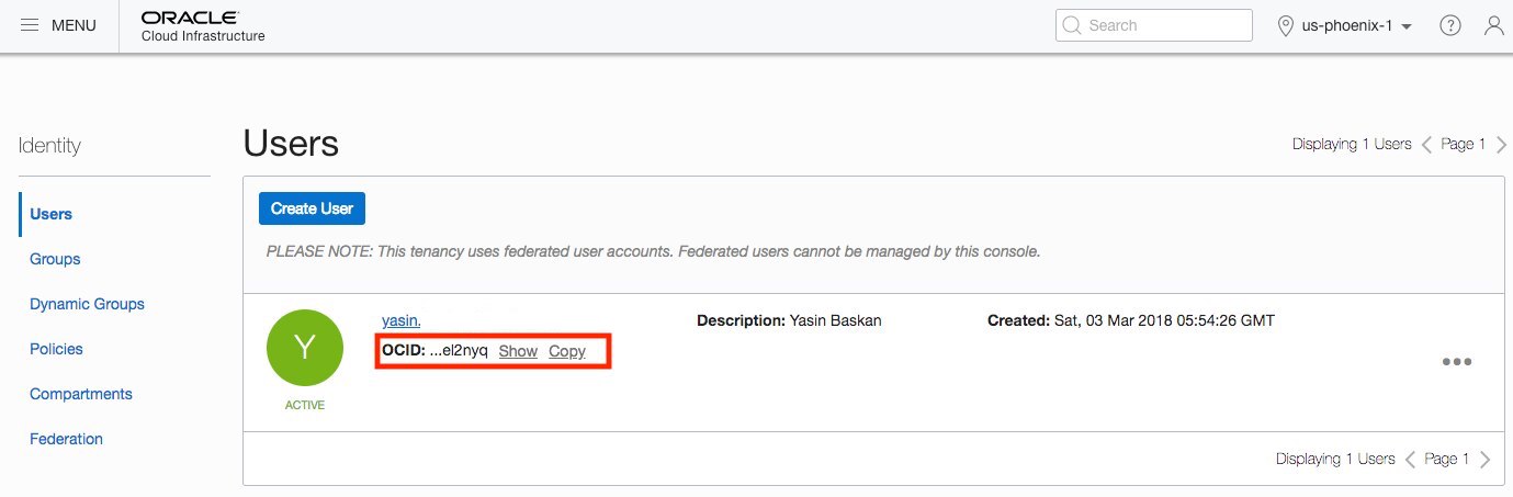

Auth User ID
This is the OCID of the user who will perform actions using oci-curl. This user needs to have the privileges to manage ADW instances in your OCI tenancy. You can find your user OCID by going to the users screen as shown in this screenshot.
Click the Copy link in that screen which copies the OCID for that user into the clipboard. Paste it into the authUserId argument in your oci-curl shell script.

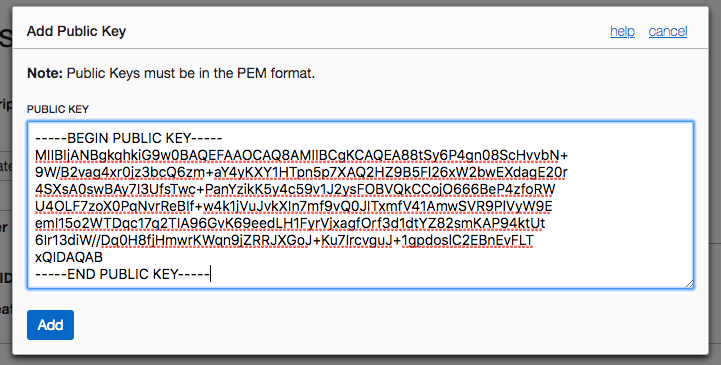

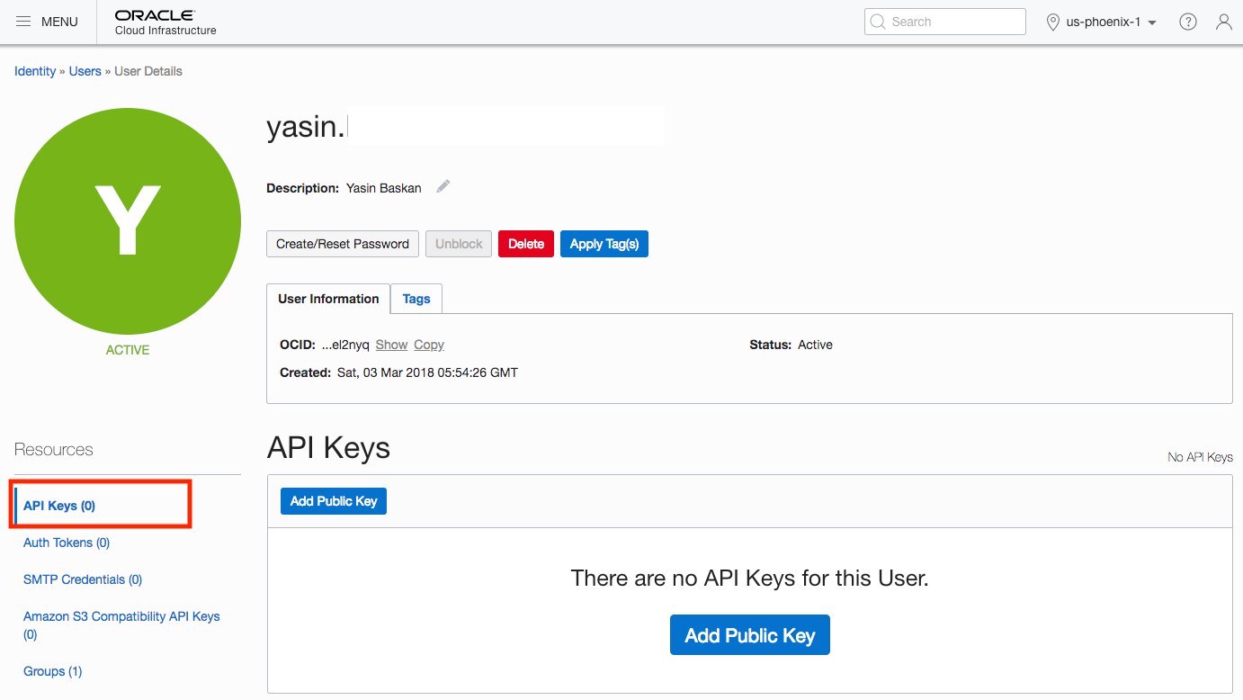

For your API calls to authenticate against OCI you need to upload the public key file. Go to the user details screen for your user on the OCI web interface and select API keys on the left.
Click the Add Public Key button and copy and paste the contents of the file oci_api_key_public.pem into the text field, click Add to finish the upload.

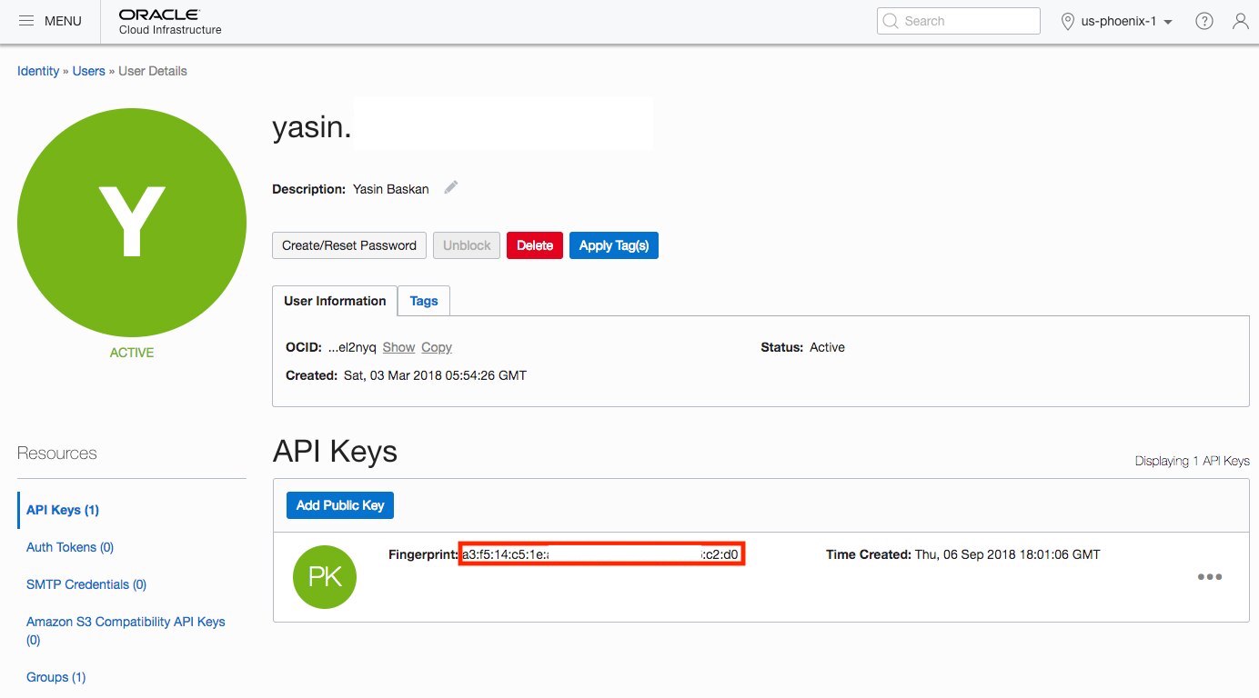

After you upload your key you will see the fingerprint of it in the user details screen as shown below.
Copy and paste the fingerprint text into the keyFingerprint argument in your oci-curl shell script.

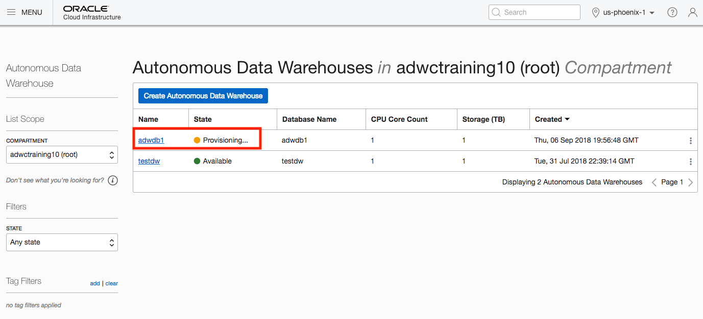

As you see the lifecycle state is listed as provisioning which indicates the database is being provisioned. If you now go to the OCI web interface you will see the new database as being provisioned.

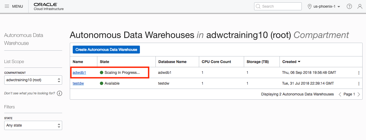

Scaling an ADW instance
To scale an ADW instance you need to use the UpdateAutonomousDatabase REST API with the relevant arguments.
Here is my script, updateadw.sh, I use to do that.
#!/bin/bash
. ./oci-curl.sh
oci-curl database.us-phoenix-1.oraclecloud.com put ./update.json "/20160918/autonomousDatabases/$1"
As you see it uses the file update.json as the request body and also uses the command line argument $1 as the database OCID. The file update.json has the following argument in it.
  "cpuCoreCount" : 2
I am only using cpuCoreCount as I want to change my CPU capacity, you can use other arguments listed in the documentation if you need to.

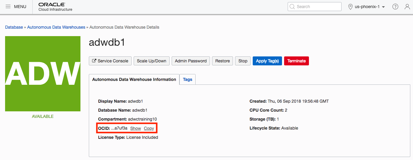

To find the database OCID for your ADW instance you can either look at the output of the list databases API I mentioned above or you can go the ADW details page on the OCI web interface which will show you the OCID.
Now, I call it with my database ID and the scale operation is submitted.
$ ./updateadw.sh ocid1.autonomousdatabase.oc1.phx.abyhqljtjspizzx47fpmloya24lqhdjzkevoq

If you go to the OCI web interface again you will see that the status for that ADW instance is shown as Scaling in Progress.
