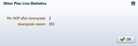

To find out the reason for the downgrade you can click the binocular icon in the OTHER column in the PX COORDINATOR line.
That shows you the actual DOP after the downgrade and the reason for the downgrade (as a cryptic code obviously) like below.
Here is the list of possible reasons and their number codes as of 12.1.
       350 DOP downgrade due to adaptive DOP
351 DOP downgrade due to resource manager max DOP
352 DOP downgrade due to insufficient number of processes
353 DOP downgrade because slaves failed to join
