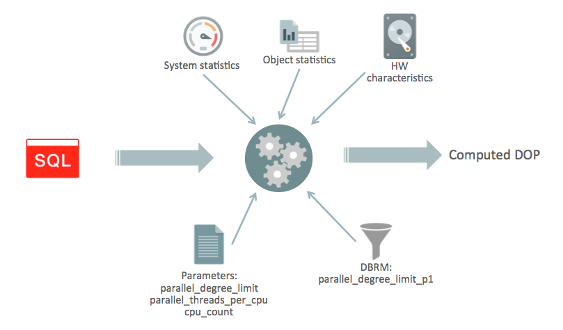

So, for any SQL statement that the optimizer decides to run in parallel with Auto DOP, it takes into account the initialization parameters, DBRM settings, system and object statistics, and HW characteristics to compute the DOP.
We have looked at what initialization parameters you can use to control Auto DOP, in the next post we will look at how system and object statistics are used and what we mean by “HW characteristics”.
