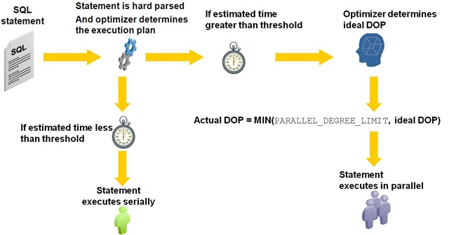

As the name says and the above description implies, Auto DOP, or Automatic Degree of Parallelism is Oracle determining the parallel degree with which to run a statement (DML, DDL and queries) based on the fastest possible plan as determined by the optimizer. That means that the database parses a query, calculates the cost and then calculates a DoP to run with. The cheapest plan may be to run serial, which is also an option. The following illustrates the decision making process:
Oracle's decision making process
The threshold that is prominently mentioned above is set by parallel_min_time_threshold. The default of this parameter is 10 seconds. If you want to run more statements in parallel, make sure to reduce that number so that more plans qualify for parallel evaluation.
The other parameter mentioned in the above is the parallel_degree_limit. Parallel_degree_limit is the maximum DOP that can be used. By default this is set to the value of "CPU". In this case CPU means Default DOP, which in turn is calculated as the total CPU count of the system (if this is a cluster, it includes all CPUs in the cluster)multiplied with the value of the parameter parallel_threads_per_cpu. On a 32 CPU system (cluster or single machine) this is 32 * 2 = 64.
The DOP that we run the statement is the minimum value of the computed DOP (or ideal DOP) and that parallel_degree_limit parameter. Within the explain plan you will see the actual DOP and whether or not we capped it. If we cap it you see something like " degree of parallelism is 64 because of parallel threshold".

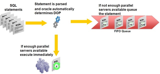

The answer to this is Parallel Statement Queuing. The long and short of parallel statement queuing is that a statement runs when its requested DOP is available. E.g. when a statement requests as DOP of 64, it will not run if there are only 32 processes currently free to assist this customer. As with the annoying telephone systems, the statement will be placed into a queue. However, Oracle does enforce a strict First In - First Out queue, never so sure about the phone systems on that one...
In the picture below you can see this in action. Let's say a statement requests to be run with a DOP of 8. Enough processes are around and available, and Oracle just runs the statement with DOP of 8.
parallel_statement_queue_step0
Not all that interesting. Now if a statement comes in that wants to run with a DOP of 128 and there are no 128 parallel processes available to start working, the statement gets queued. There is a threshold before this is starting, but more on that later.
parallel_statement_queue_step1
The statement requesting DOP 128 is being queued and is first in the queue as shown above. Subsequent statements requesting DOPs of 16, 32 and 64 are nicely queued as well, behind our first arrival. All running statements will of course run and complete. Once the 128 processes are around, our first in the queue will run and the queue will clear out as more processes come available.
You will only get parallel statement queuing once you reach a certain threshold (and if parallel_degree_policy is set to auto). That threshold is called parallel_server_target. The default value for parallel_server_target is set to 4 times the default DOP. On our system above with 32 CPUs and a default DOP of 64, the threshold is 256. This means that as soon as 256 parallel processes on this box are busy, queuing starts to happen.
A random example could be that there is a session running with DOP of 128, one is running with 64 and four statements are running with DOP of 16. Now if the above picture occurs, e.g. a statement requires DOP of 128, that statement is queued.
