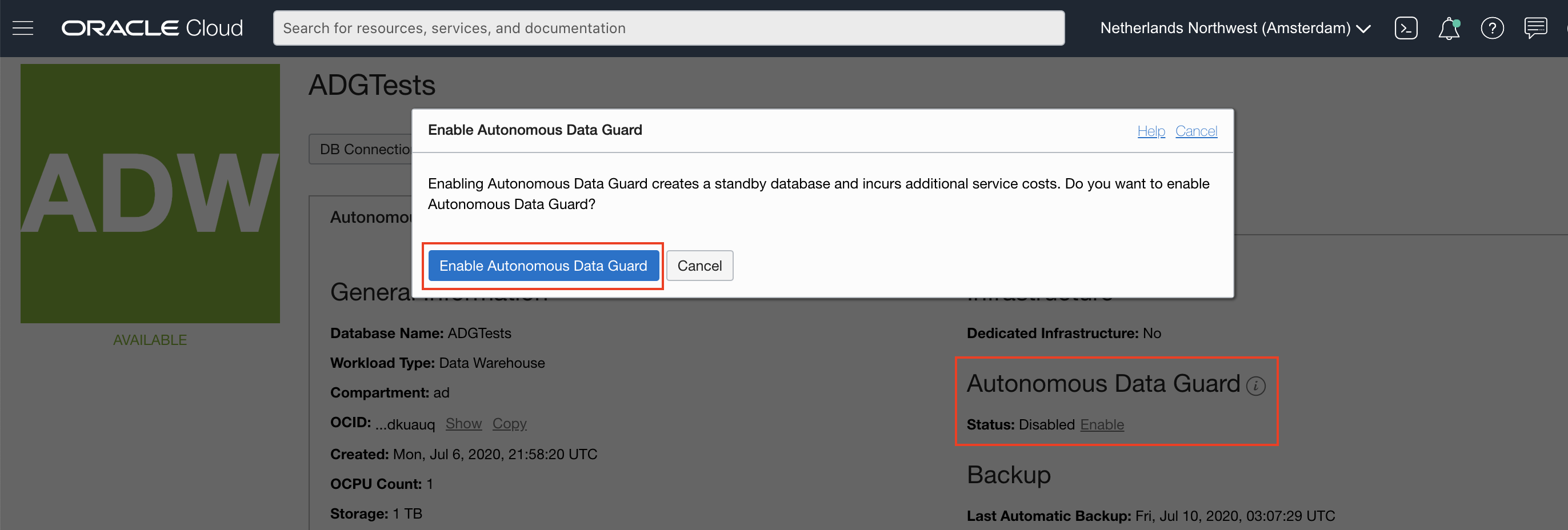

Armed with the above knowledge, let's dive right into using Autonomous Data Guard. You already know how to navigate to your Autonomous Database console in OCI, by clicking on your database name in your list of database instances. As before, you should be using a 19c version database.
Like magic, you now see Autonomous Data Guard as an option on your console. Click the "Enable" button on your console, followed by clicking the "Enable Autonomous Data Guard" confirmation button. (Okay, I lied... It's 2 clicks, not 1).
You're done, that's all you need to do to protect your database! You will now see your peered standby database in a Provisioning state until it becomes Available; depending on the size of your primary database this may take several minutes. Note that when you switch your standby to make it your primary as described below, you will not need a new wallet - Your existing wallet will continue to work seamlessly!

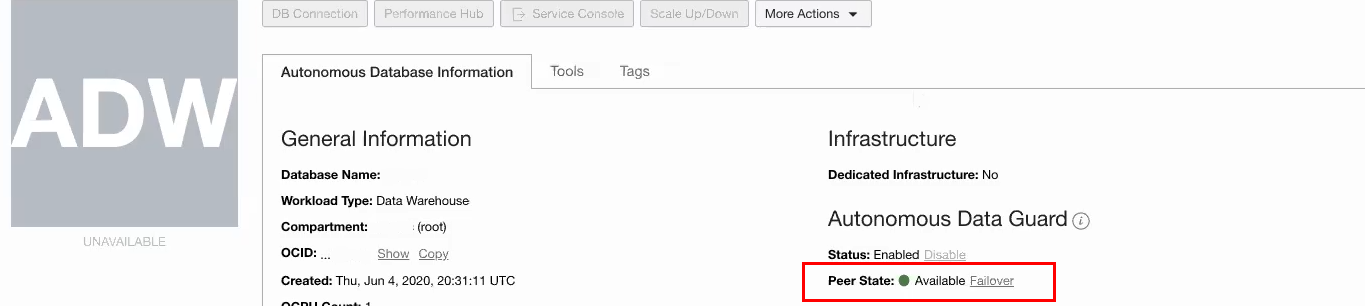

Failover - When your Primary database goes down, you are automatically protected by your Standby database
If a disaster were to occur and your primary database is brought down, you can "Failover" to your standby. A failover is a role change, switching from the primary database to the standby database when the primary is down and Unavailable, while the standby is Available.
  • An Automatic Failover is automatically triggered (no user action needed) by the Autonomous Database when a user is unable to connect to their primary database for a few minutes. Since this is an automated action, we err on the side of caution and allow auto-failovers to succeed only when we can guarantee no data loss will occur.
    For automatic failover, RTO is 2 minutes and RPO is 0 minutes.
  • In the rare case when your primary is down and Automatic Failover was unsuccessful, the Manual Failover button may be triggered by you, the user. During a manual failover, the system automatically recovers as much as data as possible minimizing any potential data loss; there may be a few seconds or minutes of data loss. You would usually only perform a Manual Failover in a true disaster scenario, accepting the few minutes of potential data loss to ensure getting your database back online as soon as possible.
    For manual failover, the RTO is 2 minutes and RPO is 5 minutes.
After a failover, a new standby for your primary will automatically be provisioned.

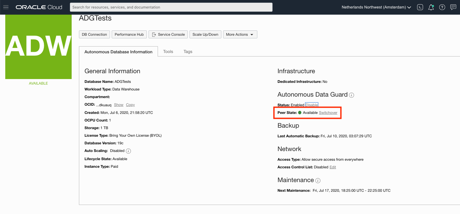

Switchover - Test your applications with Autonomous Data Guard when both databases are healthy
When your standby is provisioned, you will see a "Switchover" option on the console while your primary and standby databases are both healthy (ie. in the Available or Stopped states). Clicking the Switchover button performs a role change switching from the primary database to the standby database, which may take a couple of minutes, with no data loss guaranteed.
You would usually perform a Switchover to test your applications against this role change behaviour of the primary.
