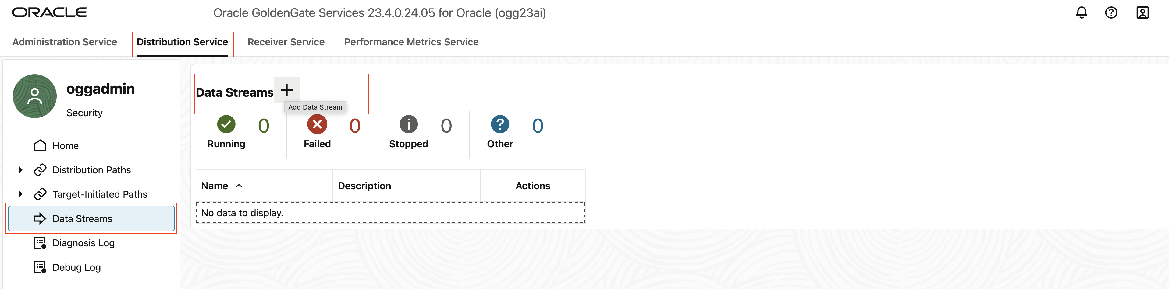

  1. In GoldenGate interface, navigate to Distribution Service and click on Data Streams. Click “Add Data Stream“.

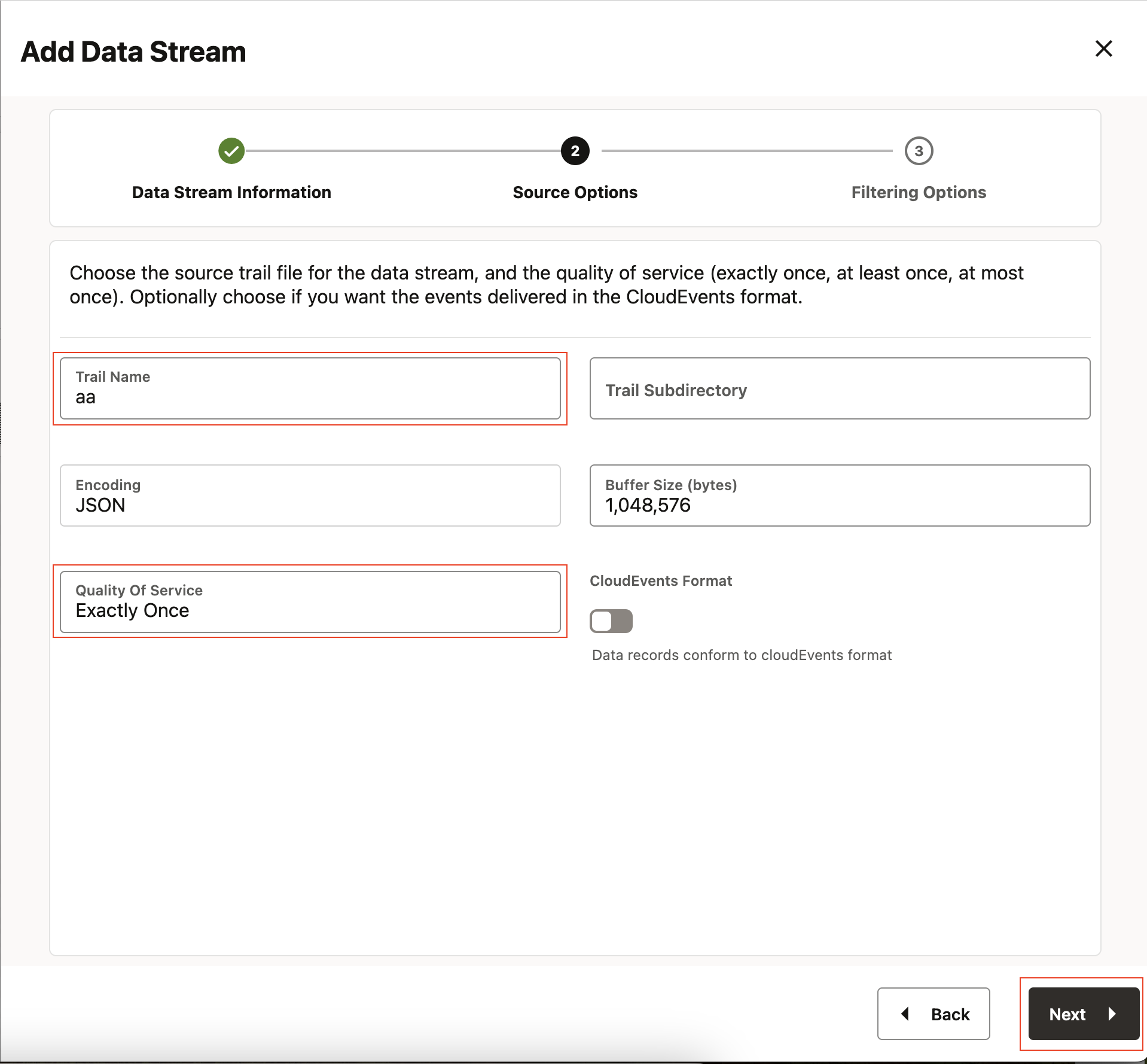

  3. In Source Options, provide your source Trail Name, select Quality of Service and click Next
    GoldenGate Data Streams

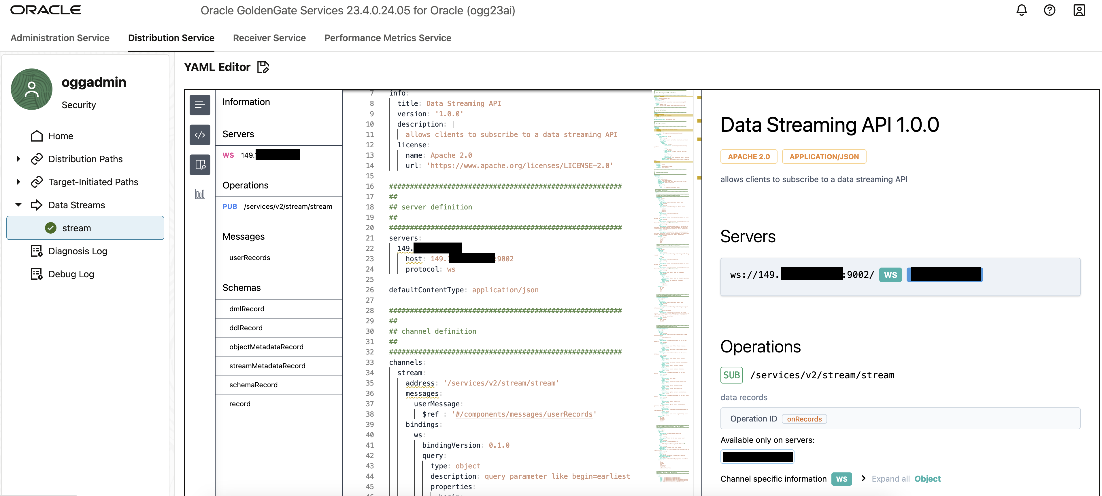

After Data Stream is created, you can review the AsyncAPI configuration file which provides all the details about server, channel, schema and object definitions. In the next step, we will be using this definition file to run the code generator.

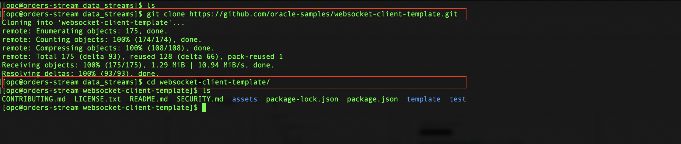

  1. Copy the gitbuh library and cd into websocket-client-template directory.
    git clone https://github.com/oracle-samples/websocket-client-template.git
    cd websocket-client-template

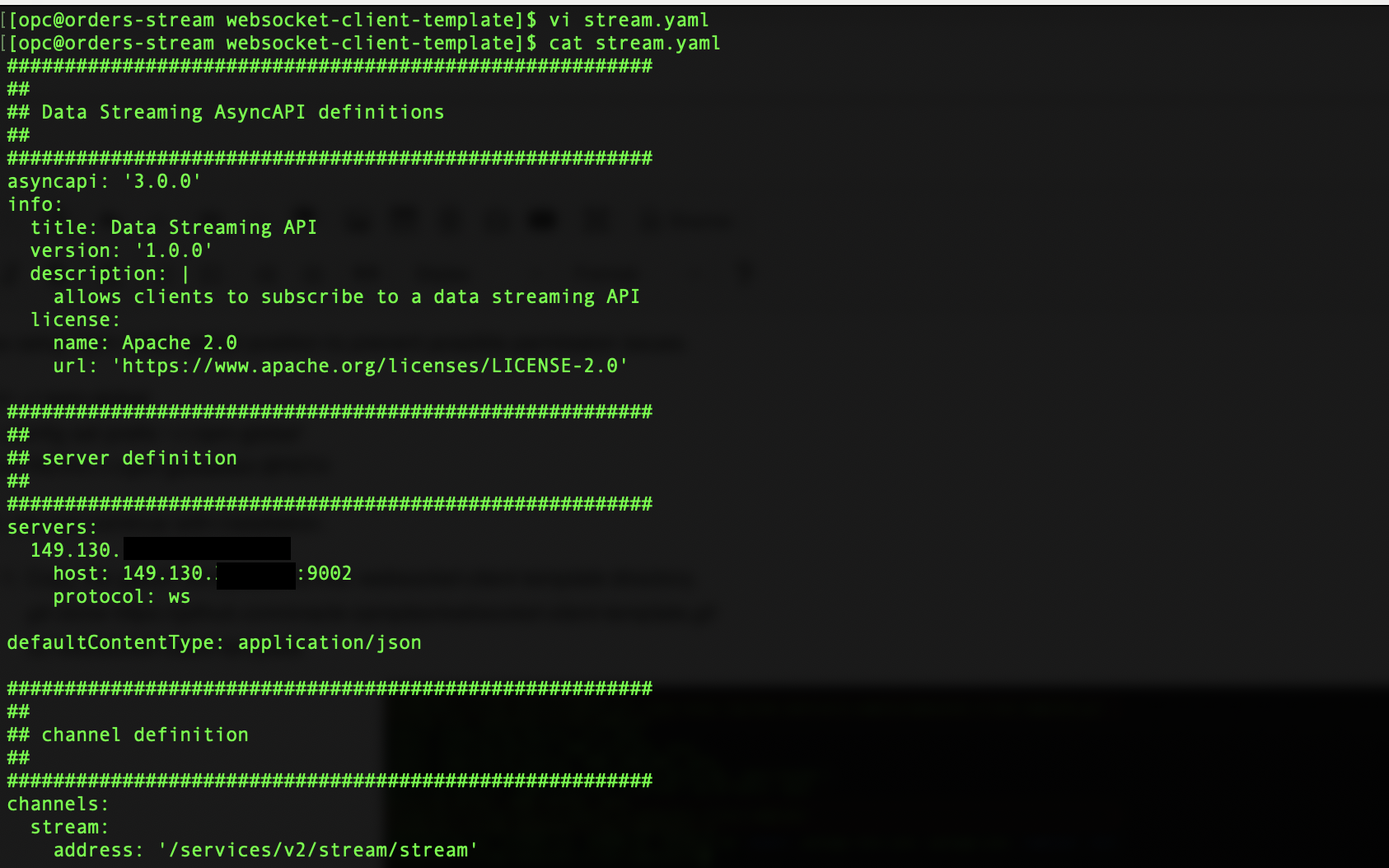

  2. Create the yaml configuration file with your GoldenGate Data Stream definition file in websocket-client-template directory. You can just create a file and copy/ paste the content from your GoldenGate Data Stream configuration file.

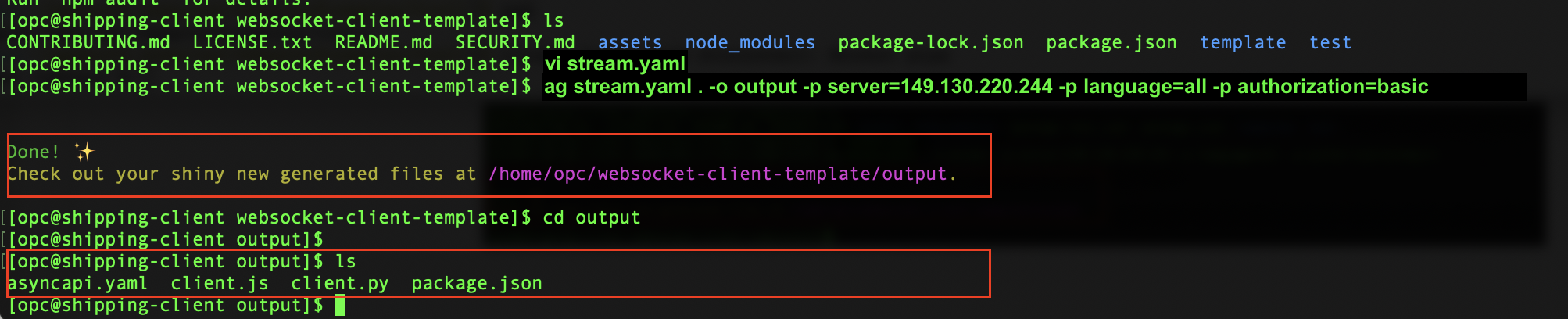

  4. Run the code generator with the asyncapi definition document you created in step two.
    ag test/streaming.yaml . -o output -p server=<GoldenGate_Host> -p language=all -p authorization=basic
    Make sure running this in websocket-client-template folder. You may need to replace ‘.’ with absolute path. You can check websocket-client-template for other configuration details.
  5. Once installation is successfully complete, you should see a message as below. You can go into output directory where the client connection codes are created. Currently, python and node.js clients are available.

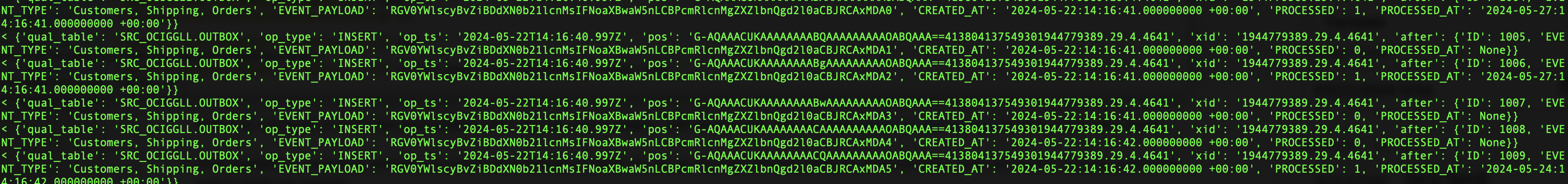

  7. When client.py is executed, it will ask for username, password (username and password you’re using for data streams. If needed, you can create a new user from User Administration) and beginning point (just hit enter for default setting as earliest).
  8. If connection is successful, client will show the messages published to GoldenGate Data Streams.
