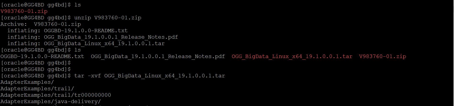

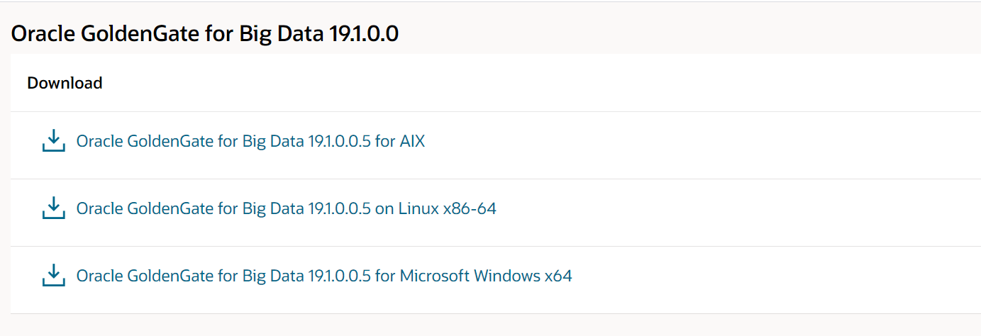

  2. Download the GoldenGate for Big Data 19.1.0.0.5 Binaries and transfer it to the Azure VM.
    https://www.oracle.com/middleware/technologies/goldengate-downloads.html

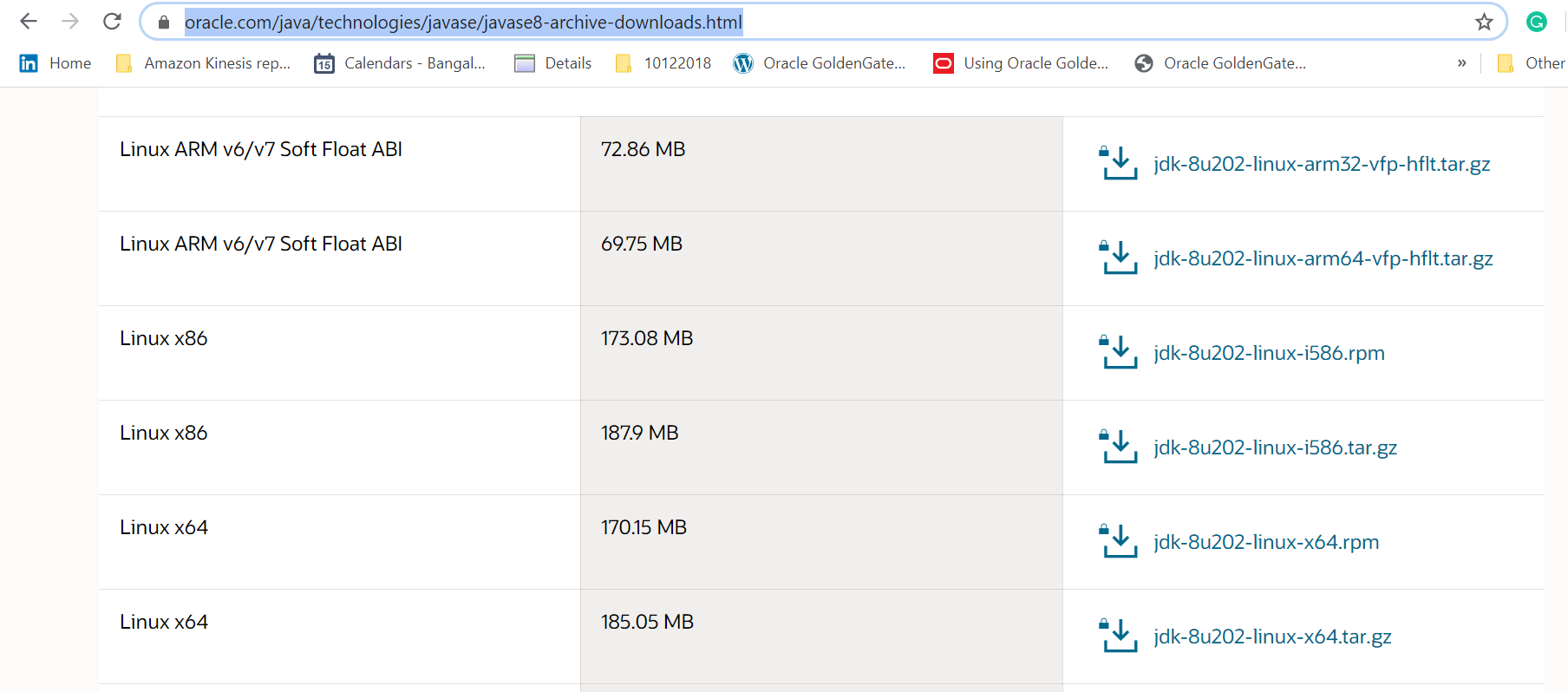

  3. Oracle GoldenGate for Big Data requires that you install Oracle Java 8 Java Runtime Environment (JRE) at a minimum. So, Download Java 1.8.202
    https://www.oracle.com/java/technologies/javase/javase8-archive-downloads.htm
    Download the GoldenGate for Big Data installers Linux x64.tar.gz file from OTN or E-delivery or Oracle Support Portal

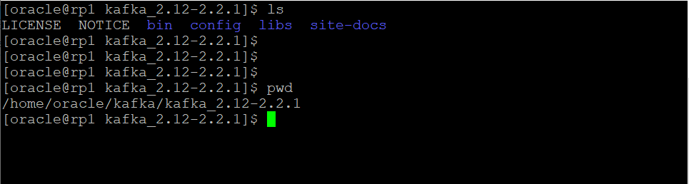

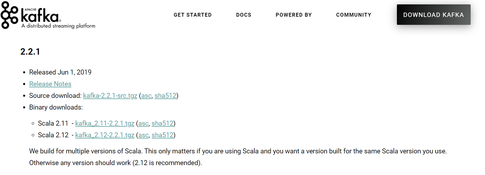

  4. Download kafka_2.12-2.2.1 from https://kafka.apache.org/downloads

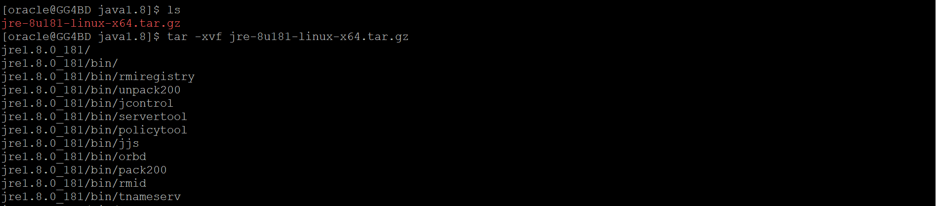

  5. Extract/Unzip GoldenGate for Big data,Java1.8 and kafka_2.12-2.2.1 into separate directories.

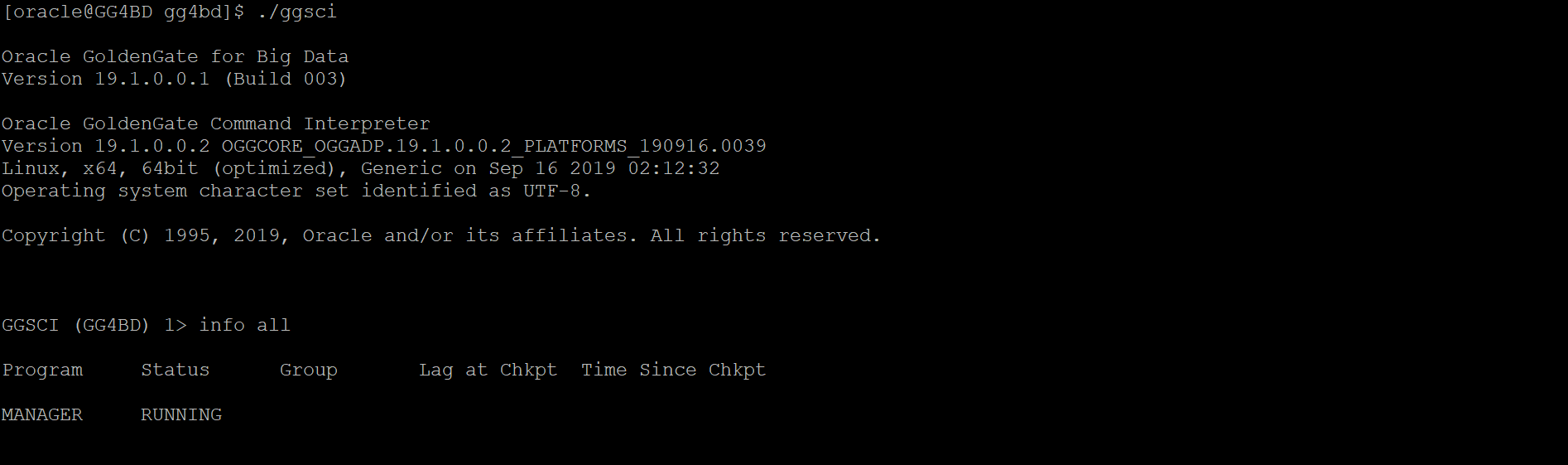

  7. Traverse to the GoldenGate for Big Data directory and login into the ggsci prompt
    Edit the parameter file of manager and specify the manager PORT, Save and close it
    Edit params mgr
    PORT 7809
    Start mgr

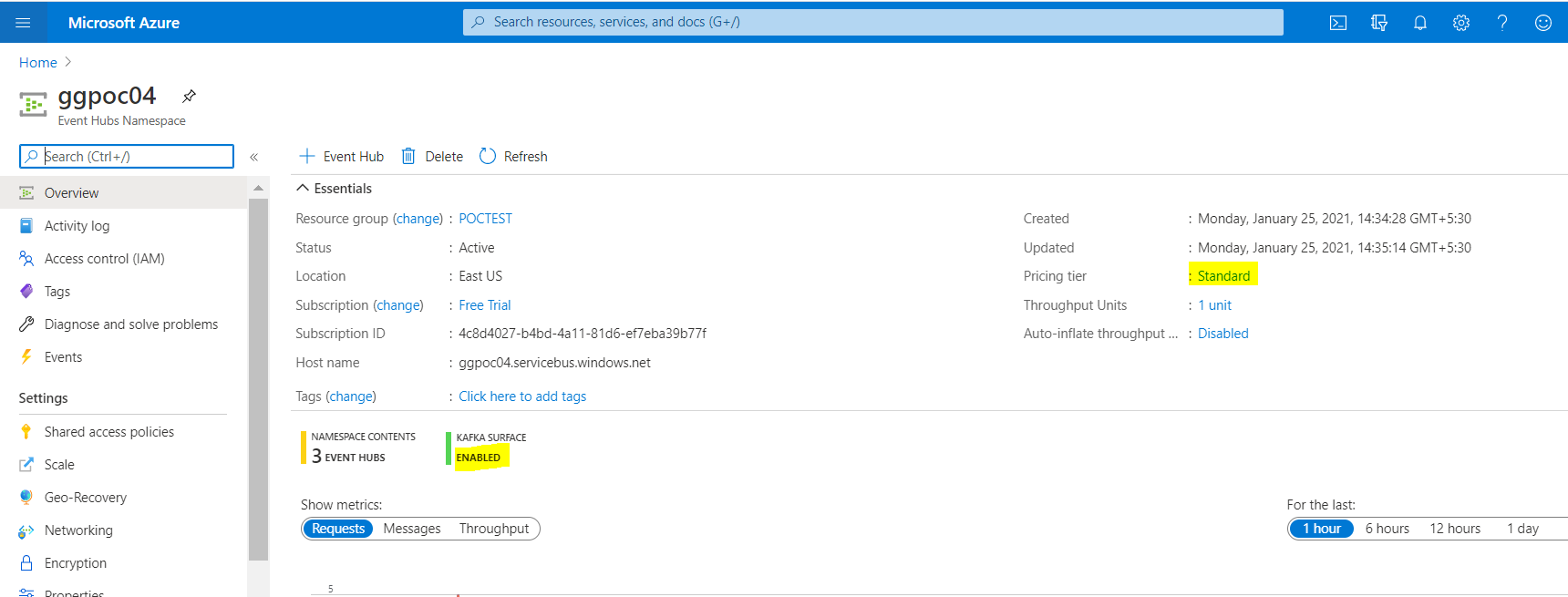

  8. From the Azure portal, Navigate to All Services and select Event Hubs and follow the steps mentioned in the below link to setup an Event Hub Namespace https://docs.microsoft.com/en-us/azure/event-hubs/event-hubs-create. And make sure you select the Standard option under Pricing Tier as Basic option doesn’t allow Kafka to be enabled for the Event Hub.

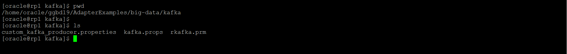

  9. Go Back to the GoldenGate directory, Traverse to AdapterExamplesàbig-data-àKafka
    And copy sample rkafka.prm, custom_producer.properties and kafka.props file to GoldenGate dirprm directory.

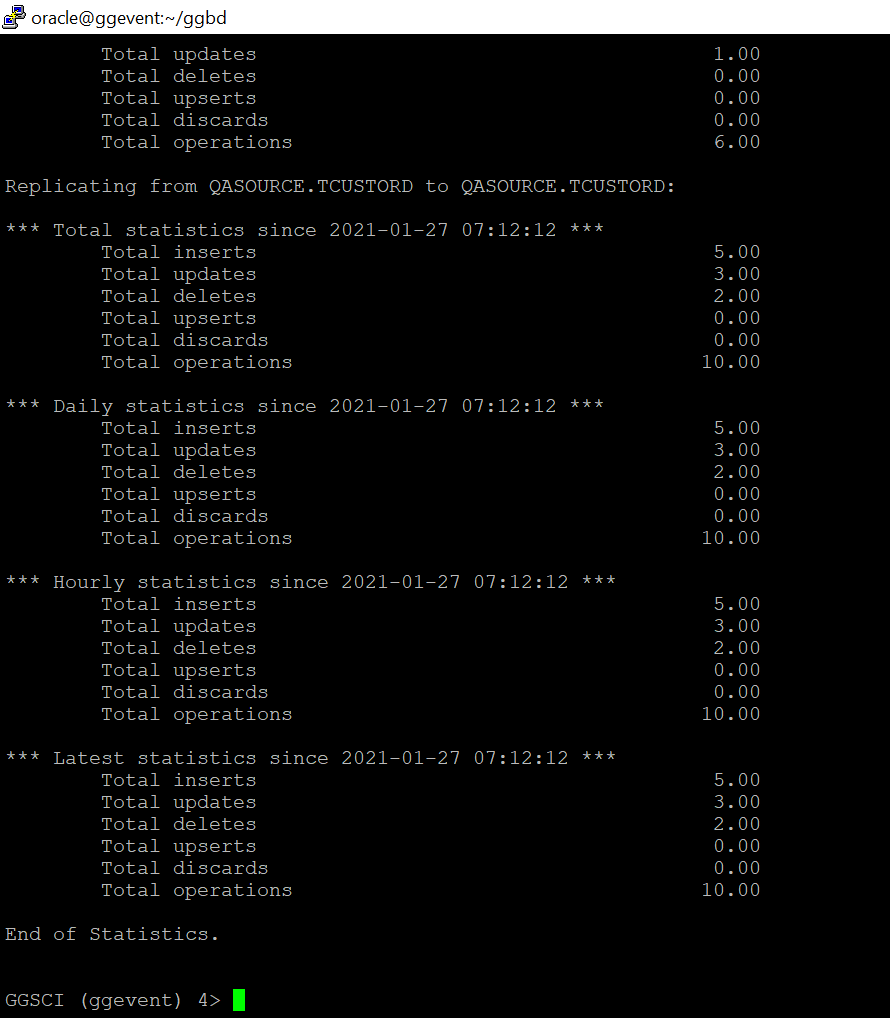

15. Now check the Statistics for the Replicat by using the stats command-

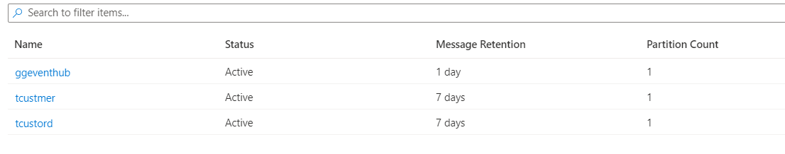

16. Note that the topics are created automatically based on the table name in Azure Event Hub, as we have set gg.handler.kafkahandler.topicMappingTemplate=${tableName} .

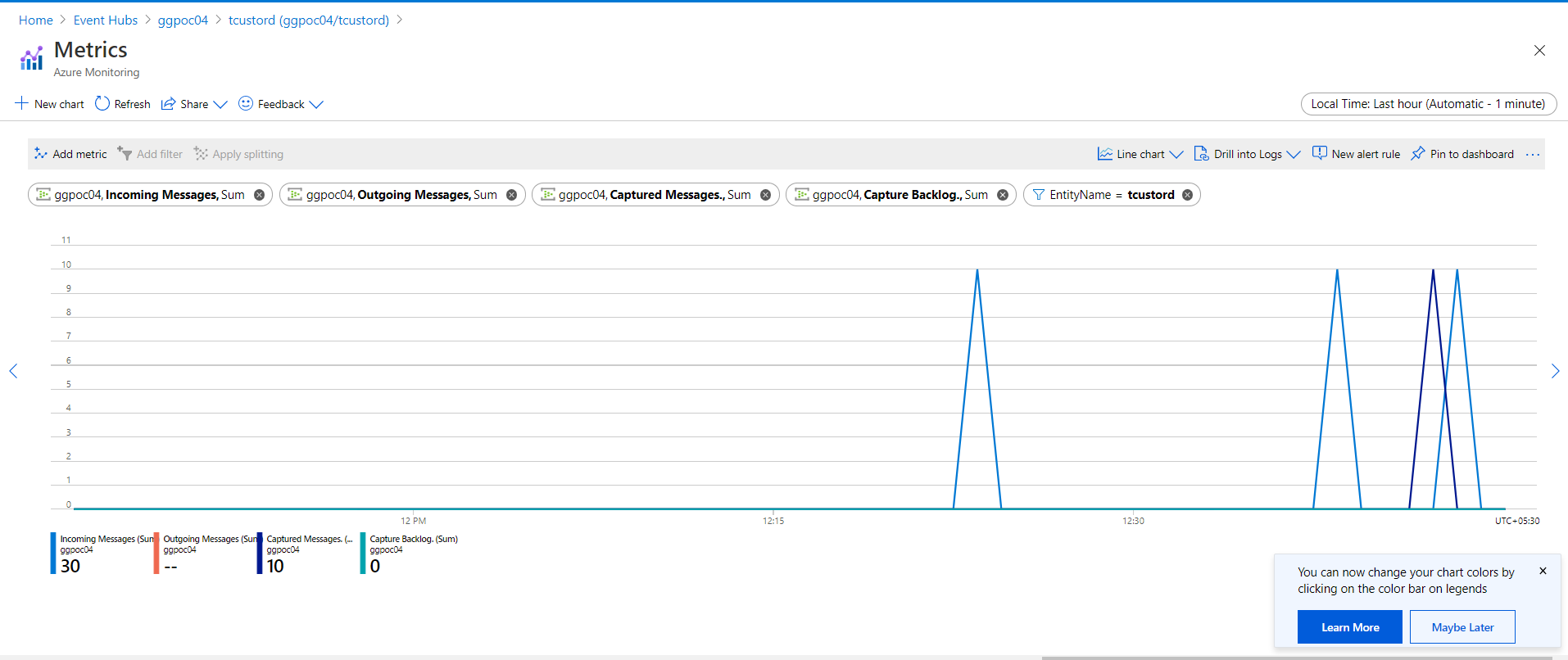

17. Check the stats/Incoming Messages on the Azure Portal (Event Hub)-
