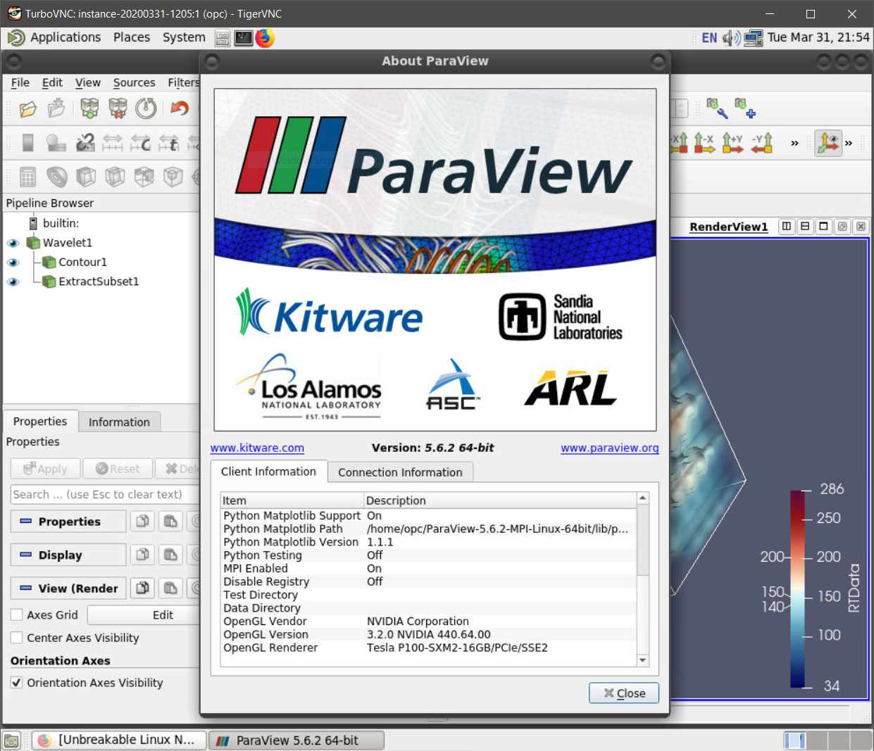

Authenticate with a one-time password and enjoy your new 3D accelerated remote Linux workstation.
Screenshot that shows the About page for the TurboVNC graphical user interface ParaView.
