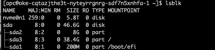

  1. Run the lsblk command on each worker node to identify NVMe devices. I am using VM.DenseIO2.8 for the compute shape in this example. The following example output shows just one NVMe device, nvme0n1.
    Screenshot of the command line that shows the result of running the lsblk command.

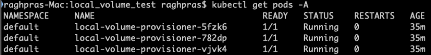

kubectl create -f ./provisioner/deployment/kubernetes/provisioner_generated.yaml
Screenshot of the command line that shows the result of running the kubectl get pods command.

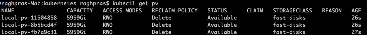

$ kubectl get pv
Screenshot of the command line that shows the result of running the kubectl get pv command.

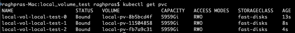

After the stateful is up and running, the PVCs are bound:
Screenshot of the command line that shows the PVCs with a Bound status.
