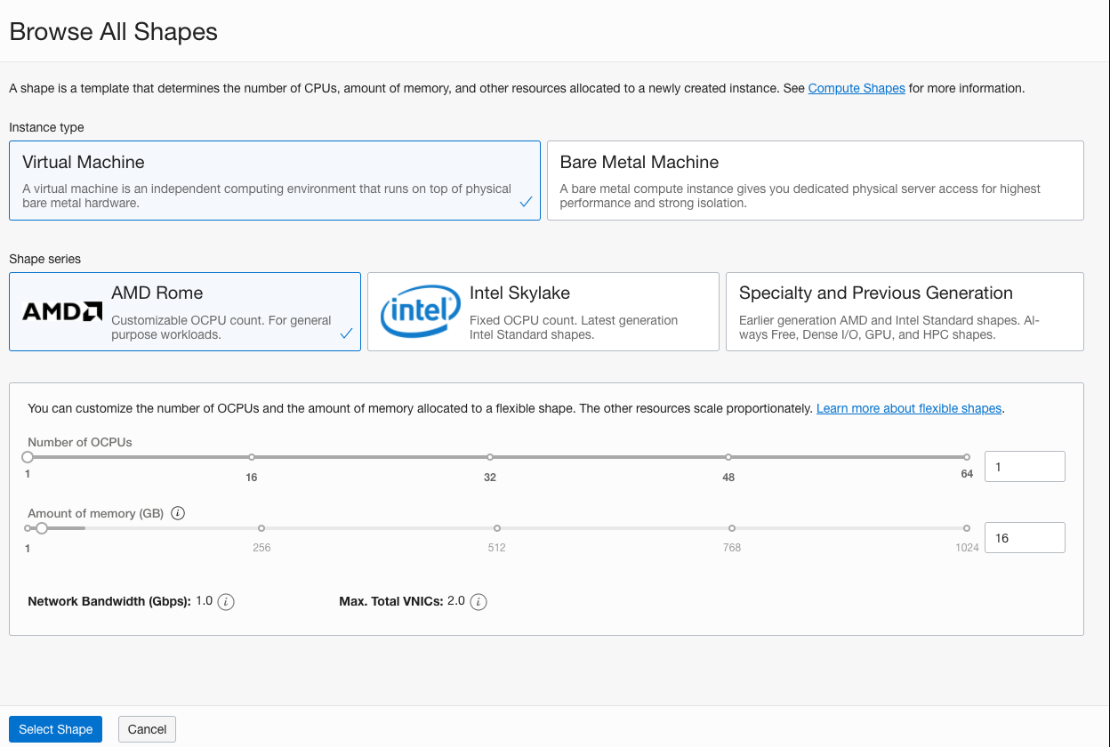

A flexible shape is a template that you can deploy for your virtual machine (VM). It lets you customize the number of OCPUs and the amount of memory, which you can later adjust without any need for application redeployment. The following options are available for flexible AMD shapes:
VM.Standard.E4.Flex (Not available in government regions yet)
This flexibility lets you build VMS based on your workload and achieve lower costs by adjusting your instances to your ideal size.
When you’re creating your instance, select flexible AMD shape and adjust OCPUs and amount of memory as needed. If you already have a shape selected in your current instance and want to migrate a Flexible AMD shape, it’s an easy two-step process to update your infrastructure: Shut down the instance, change the shape, and restart. If you’re unsure which shape is right for you or need more details on sizing, check out this blog on adequately sizing your workloads.
