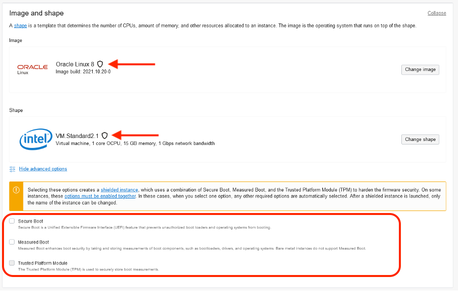

Setup
Enabling shielded instances is easy. You follow the standard instance deployment flow. Images and shapes that support shielded instances have a shield icon next to the image and shape. When you choose the image and shape that support shielded instances, you can enable secure and measured Boot in the Advanced Options. Enabling measured boot for VMs automatically enables vTPM as well.
After the VM or bare metal instance boots securely, the instance information page lists if secure boot, measured boot, and TPM are enabled. You can view and download the boot component measurements stored in the TPM from the Shielded Instance tab. Subsequent reboots then use the measurements to verify that the boot components weren’t modified by any malware and validate the integrity of the boot process.
A screenshot of the Image and Shape screen in the Console with red arrows pointing to the shield icons and the options for shielded instances circled in red.
