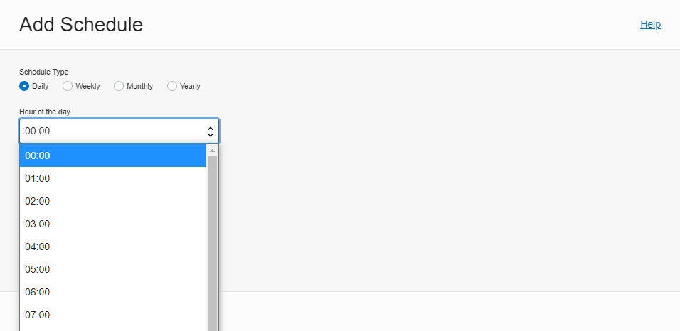

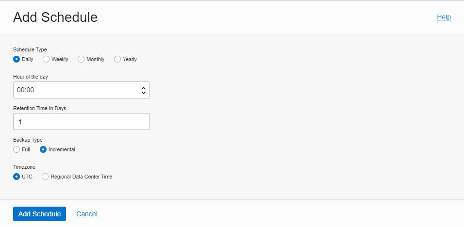

If you take a closer look to the configuration as shown in the following screenshot, when adding schedule, you can choose the schedule type as either, Daily, Weekly, Monthly or Yearly.
And for daily schedule, if you scroll down the hour of the day, as per the screenshot shown below, you can only select at most once everyday.
What if you want to backup every 2 or 3 hourly. There is no way (at least as of now) that you can achieve it in the web console. So here is the workaround that I would show you.

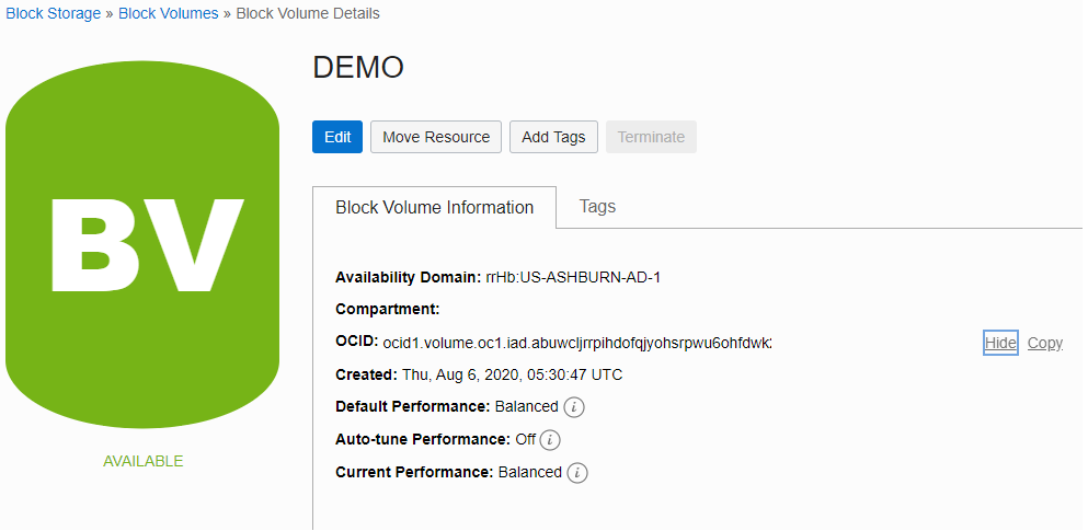

To create a backup of a block volume, find out the block volume id. It is the OCID field in the block volume details.
