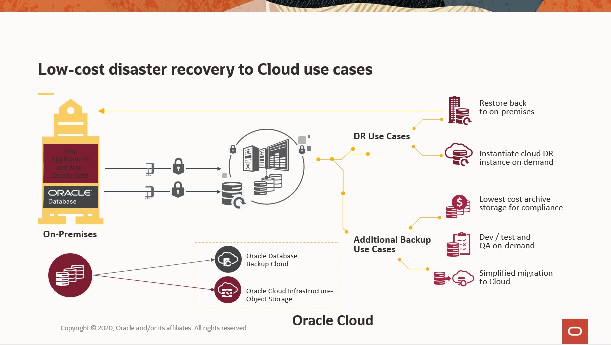

The customer didn’t plan to keep anything on-premises, but these best practices apply to Oracle Government Cloud and on-premises. If you plan to keep your on-premises data center as your primary and use Oracle Government Cloud as your disaster recovery site, that too is a viable option. Use Oracle Government Cloud Object Storage as your backup target. Restore from Oracle Cloud Object Storage to Oracle Government Cloud. This scenario might require third part tools. Optionally, for your Oracle Databases, you can enable Oracle Data Guard and maintain disaster recovery for your Oracle Databases.
