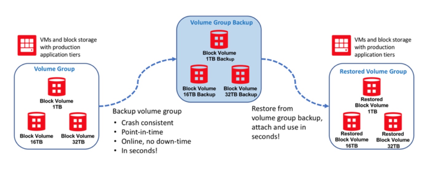

Volume Group
For this customized volume backup script, we recommend using the volume group feature to a create block volume backup. This feature enables you to group multiple block volumes and create a collection of volumes from which you can create consistent volume backups and clones. You can restore an entire group of volumes from a volume group backup.
