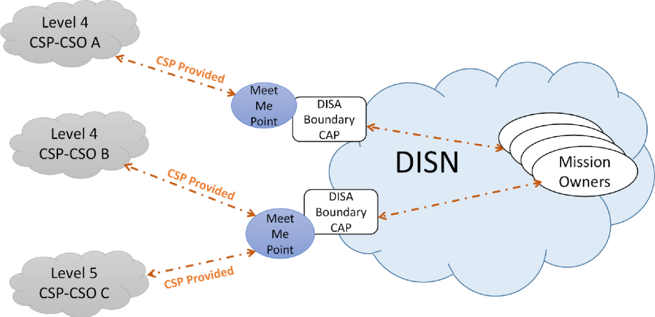

CSP-CSO Connection to the DISA Enterprise Boundary Cloud Access Point (BCAP).
Figure 1: CSP-CSO Connection to the DISA Enterprise Boundary Cloud Access Point (BCAP) (Department of Defense CCPG- Page 17, figure 6)

The mission owner determines the connection requirements to BCAPs ahead of time. Based on disaster recovery and high-availability requirements, the mission owner should consider having at least two connections to each of the East and West BCAPs. The mission owner works with the CSP and DISA to ensure that the correct number of physical circuits are established in each BCAP region.
