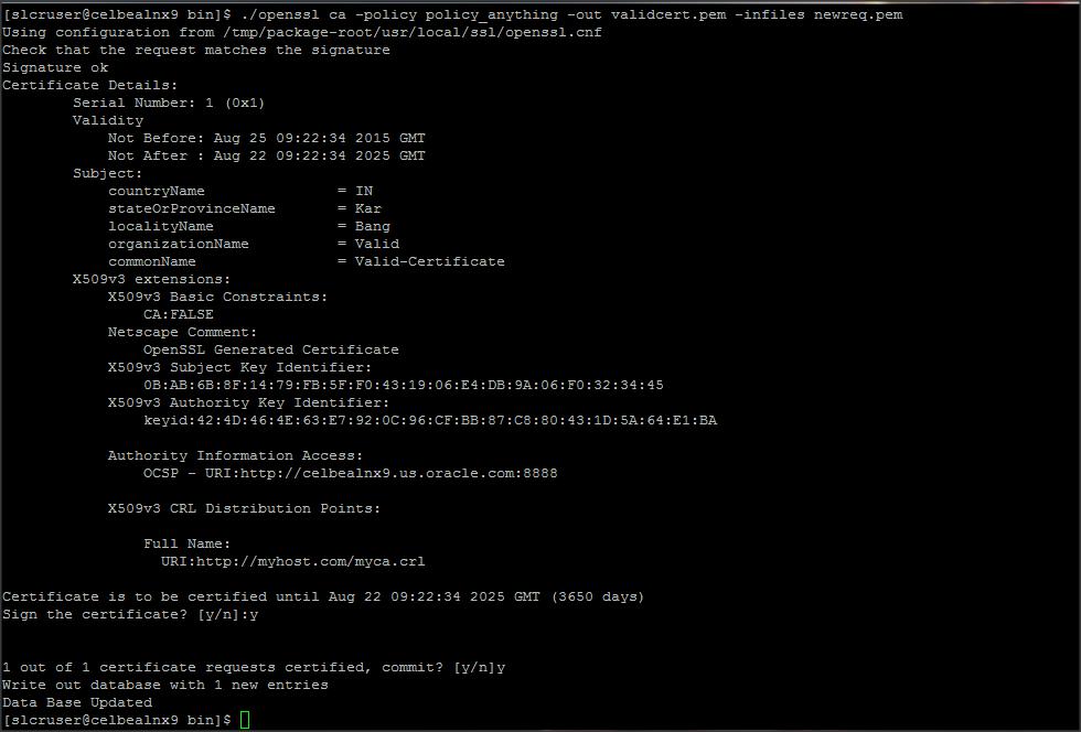

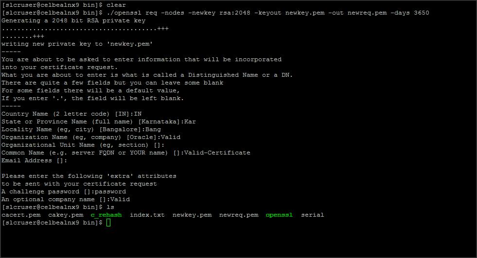

Create a certificate and get it signed by internal CA. (say Valid certificate)
Command :
./openssl req -nodes -newkey rsa:2048 -keyout newkey.pem -out newreq.pem -days 3650
./openssl ca -policy policy_anything -out validcert.pem -infiles newreq.pem

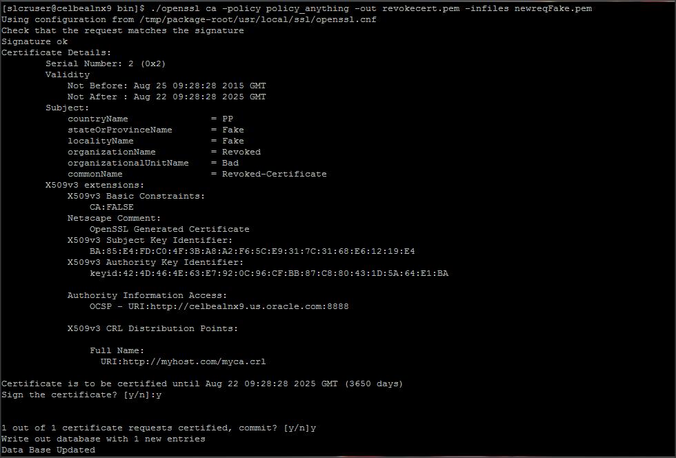

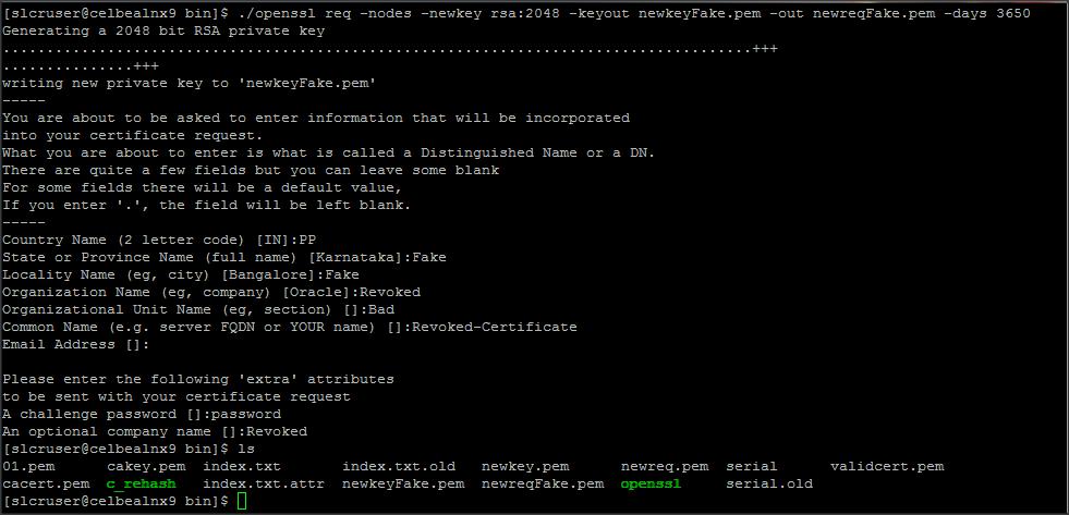

Create a certificate and get it signed by internal CA (say Revoked certificate).
Command :
./openssl req -nodes -newkey rsa:2048 -keyout newkeyFake.pem -out newreqFake.pem -days 3650
./openssl ca -policy policy_anything -out revokecert.pem -infiles newreqFake.pem

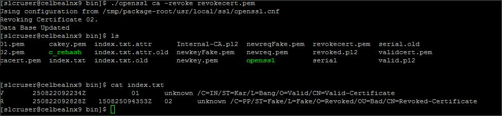

Lets revoke this certificate now :
Command :
./openssl ca -revoke revokecert.pem

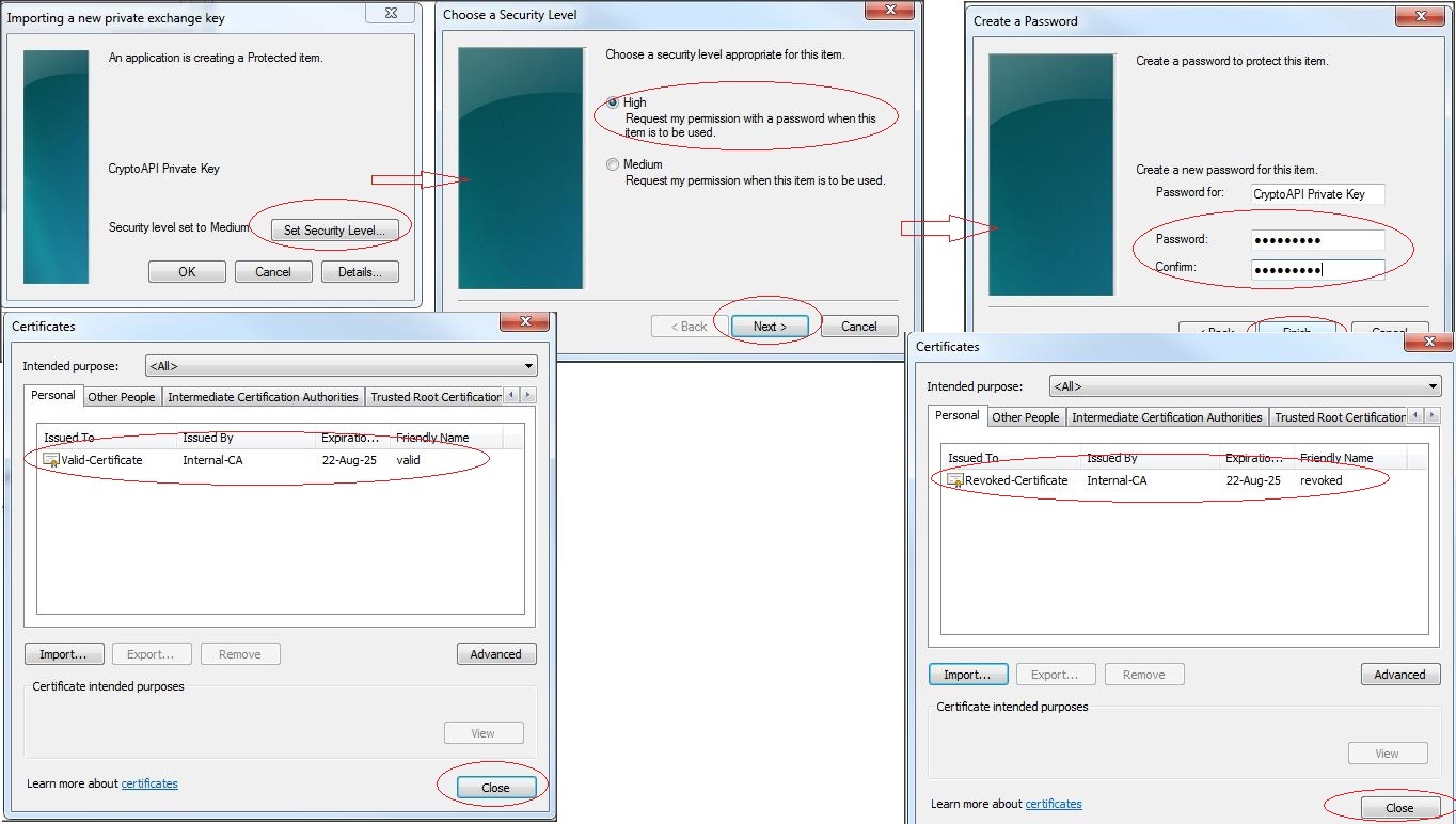

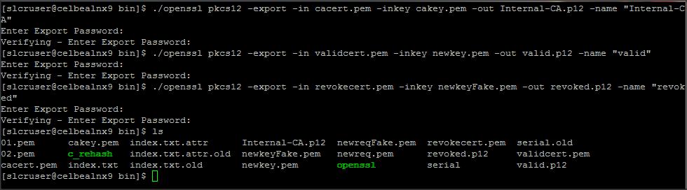

Create two .p12 keystore (valid keystore and revoked keystore) using the following command, this file will be used to configure certificates/keystore on the browser :
Command :
./openssl pkcs12 -export -in validcert.pem -inkey newkey.pem -out valid.p12 -name "valid"
./openssl pkcs12 -export -in revokecert.pem -inkey newkeyFake.pem -out revoked.p12 -name "revoked"

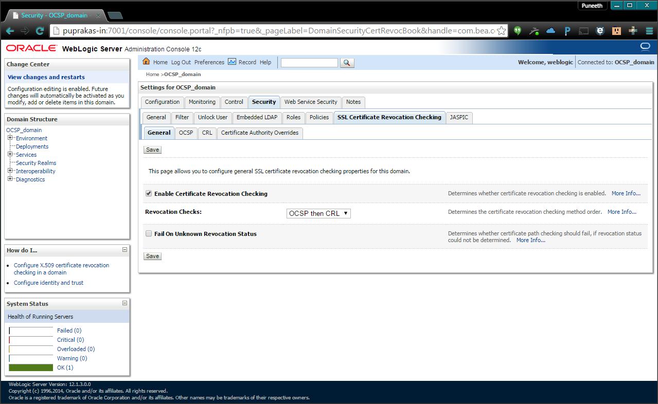

Configure Weblogic to enable OCSP based certificate Revocation Check.

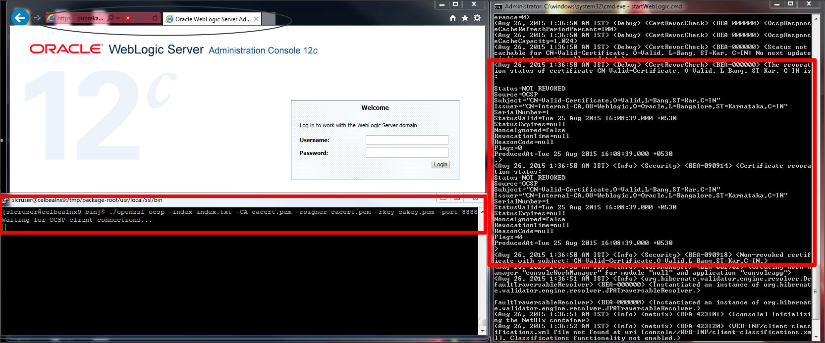

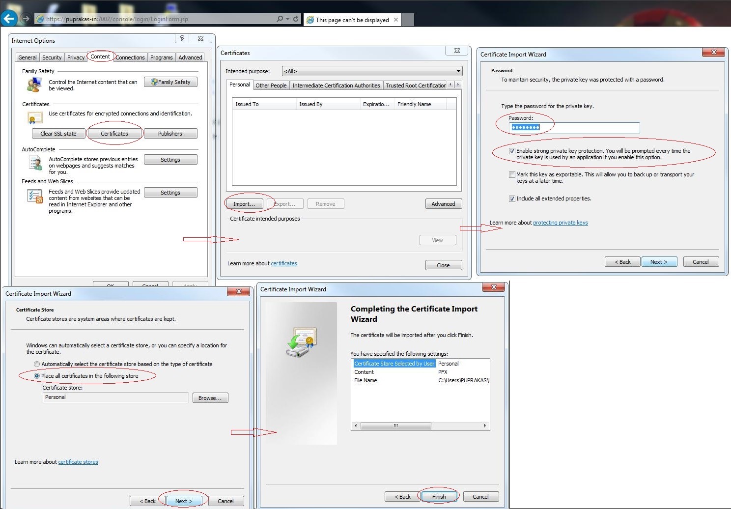

Configure a certificate signed by internal CA on your browser and access Weblogic console.
1) First configure the valid .p12 keystore --> access the console over SSL and check the Weblogic logs
2) Now delete the valid certificate.keystore from IE and configure Revoked .p12 keystore --> access the console over SSL and check the Weblogic logs

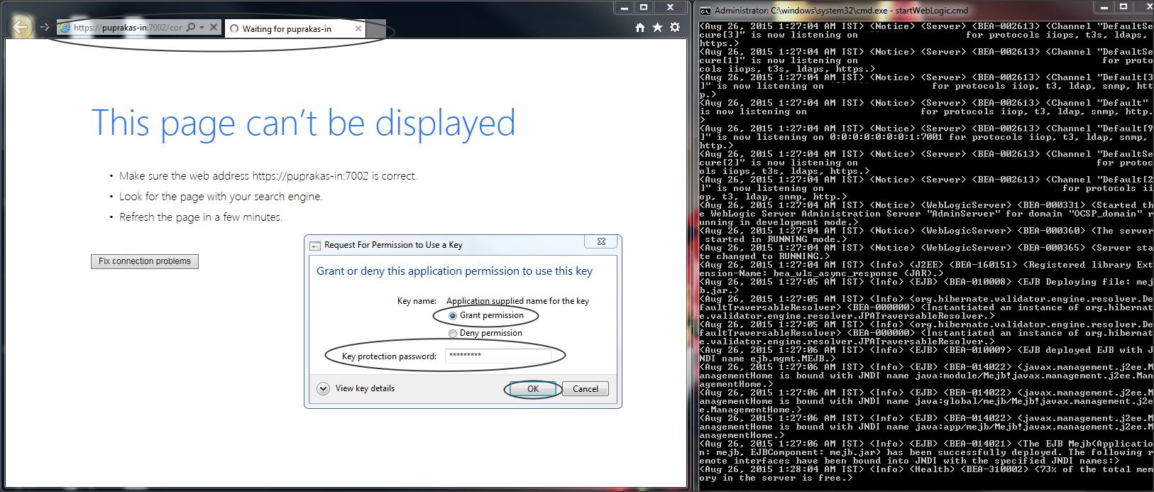

 - After successfully configuring Two-Way SSL on Weblogic Admin Server and browser (IE) --> Access WLS console over https. You should see the following :
NOTE :
- Configure a valid .p12 keystore on IE and access the Weblogic console on Https, you will see the following logging in out file :
 <Aug 26, 2015 1:36:50 AM IST> <Debug> <CertRevocCheck> <BEA-000000> <The revocation status of certificate CN=Valid-Certificate, O=Valid, L=Bang, ST=Kar, C=IN is:
Status=NOT REVOKED
Source=OCSP
Subject="CN=Valid-Certificate,O=Valid,L=Bang,ST=Kar,C=IN"
Issuer="CN=Internal-CA,OU=Weblogic,O=Oracle,L=Bangalore,ST=Karnataka,C=IN"
SerialNumber=1
StatusValid=Tue 25 Aug 2015 16:08:39.000 +0530
StatusExpires=null
NonceIgnored=false
RevocationTime=null
ReasonCode=null
Flags=0
ProducedAt=Tue 25 Aug 2015 16:08:39.000 +0530
<Aug 26, 2015 1:36:50 AM IST> <Info> <Security> <BEA-090914> <Certificate revoca
tion status:
Status=NOT REVOKED
Source=OCSP
SerialNumber=1
StatusExpires=null
NonceIgnored=false
RevocationTime=null
ReasonCode=null
Flags=0
NOTE :

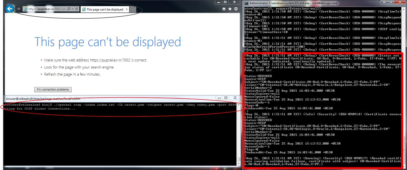

- Configure a revoked .p12 keystore on IE and access the Weblogic console on Https, you will see the following logging in out file :
 <Aug 26, 2015 1:31:51 AM IST> <Debug> <CertRevocCheck> <BEA-000000> <The revocation status of certificate CN=Revoked-Certificate, OU=Bad, O=Revoked, L=Fake, ST=Fake, C=PP is:
Status=REVOKED
Source=OCSP
Subject="CN=Revoked-Certificate,OU=Bad,O=Revoked,L=Fake,ST=Fake,C=PP"
SerialNumber=2
StatusValid=Tue 25 Aug 2015 16:03:41.000 +0530
StatusExpires=null
NonceIgnored=false
RevocationTime=Tue 25 Aug 2015 15:13:53.000 +0530
ReasonCode=-1
Flags=0
ProducedAt=Tue 25 Aug 2015 16:03:41.000 +0530
<Aug 26, 2015 1:31:51 AM IST> <Info> <Security> <BEA-090914> <Certificate revoca
tion status:
Status=REVOKED
Source=OCSP
SerialNumber=2
StatusExpires=null
NonceIgnored=false
ReasonCode=-1
Flags=0
