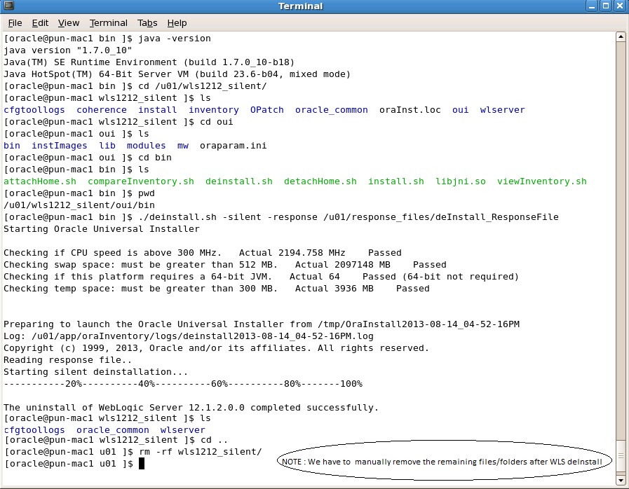

Deinstalling WLS 12.1.2 in Silent mode :

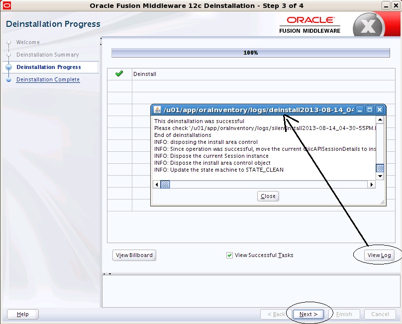

Deinstall WLS 12.1.2 in GUI mode :

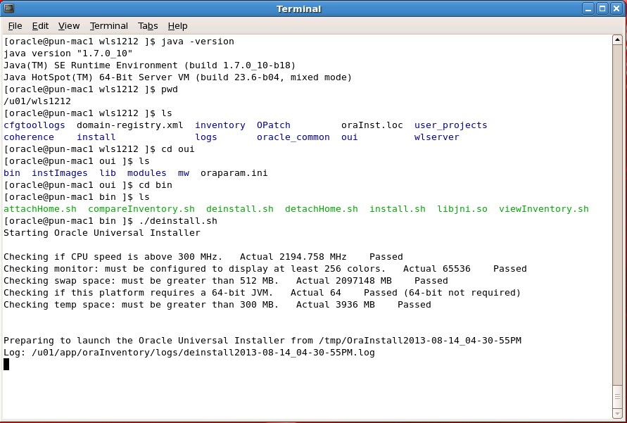

Step 1 :
Go to ” ORACLE_HOME\oui\bin ” directory and run deinstall script.

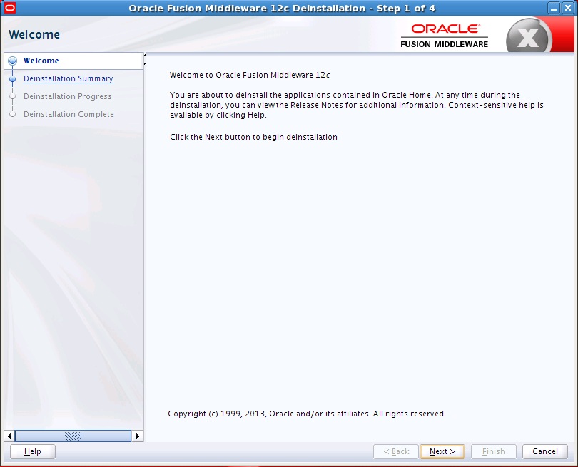

Step 2 :

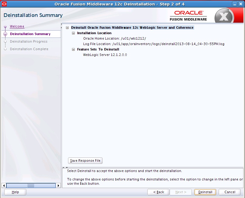

Step 3 :

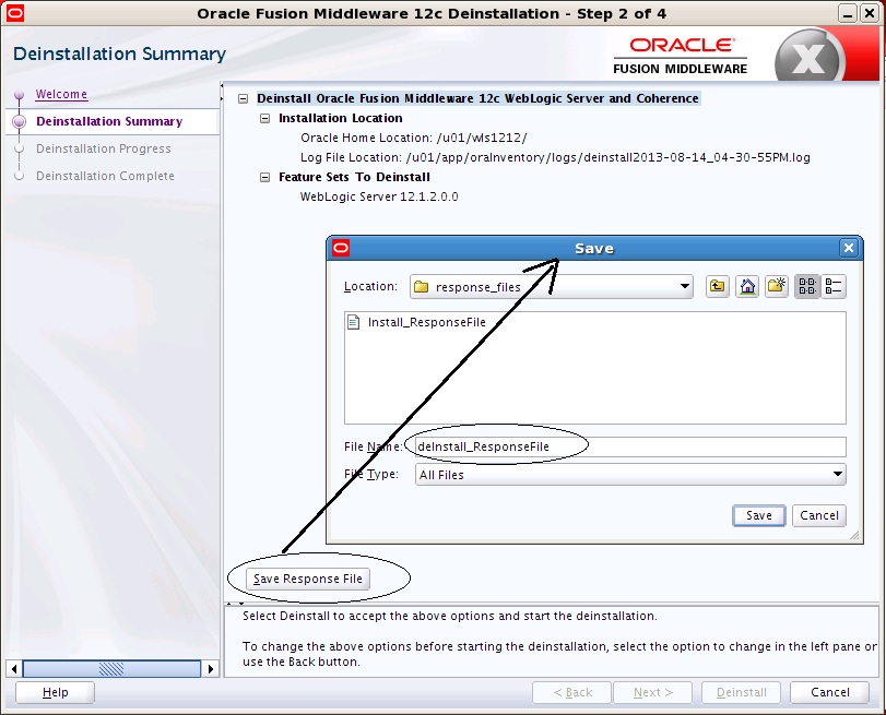

Note :
– You can save the response file for deinstaller here.
– This response file can be used to deinstall WLS in silent mode.
Step 4 :

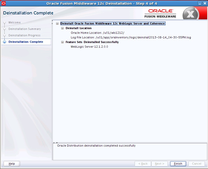

Step 5 :
“>Step 6 :
Note :

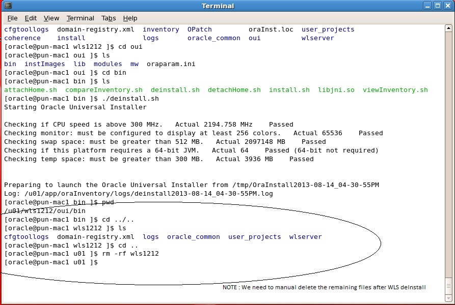

 – After running the deinstall script, not all files / folders are removed.
– To remove all the files and folder you need to manually clean up few files as shown below :
