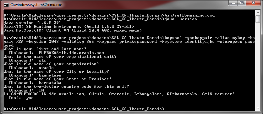

Step 1 :
Create a certficate pair using keytool genkeypair command
Command :  keytool -genkeypair -alias mykey -keyalg RSA -keysize 2048 -validity 365 -keypass privatepassword -keystore identity.jks -storepass password

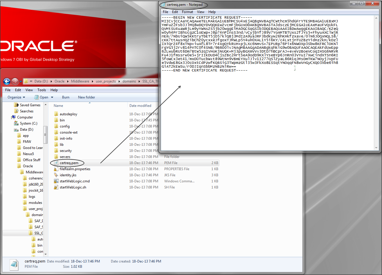

Step 2 :

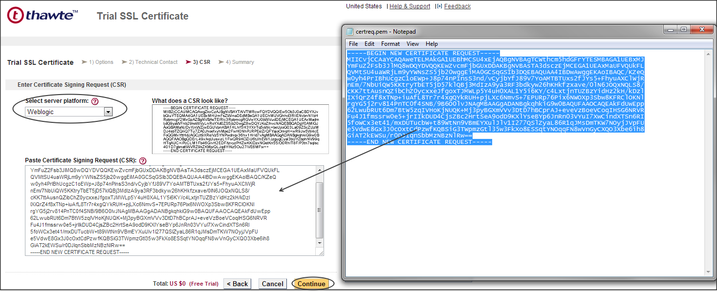

Now create a certificate signing request ( csr ) which has to be passed on to your external / third party CA ( Certificate Authority ).
Command :  keytool -certreq -alias mykey -file certreq.pem -keystore identity.jks
– The above command Generates a Certificate Signing Request (CSR), using the PKCS#10 format.
– A CSR is intended to be sent to a certificate authority (CA). The CA will authenticate the certificate requestor (usually off-line) and will return a certificate or certificate chain, used to replace the existing certificate chain (which initially consists of a self-signed certificate) in the keystore.
– sigalg specifies the algorithm that should be used to sign the self-signed certificate; this algorithm must be compatible with keyalg.
– The CSR is stored in the file certreq.pem. If no file is given, the CSR is output to stdout.

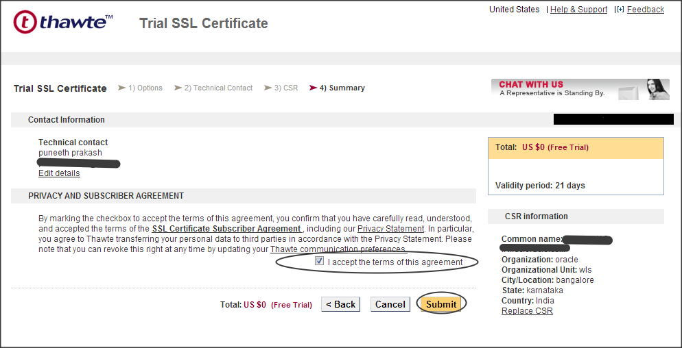

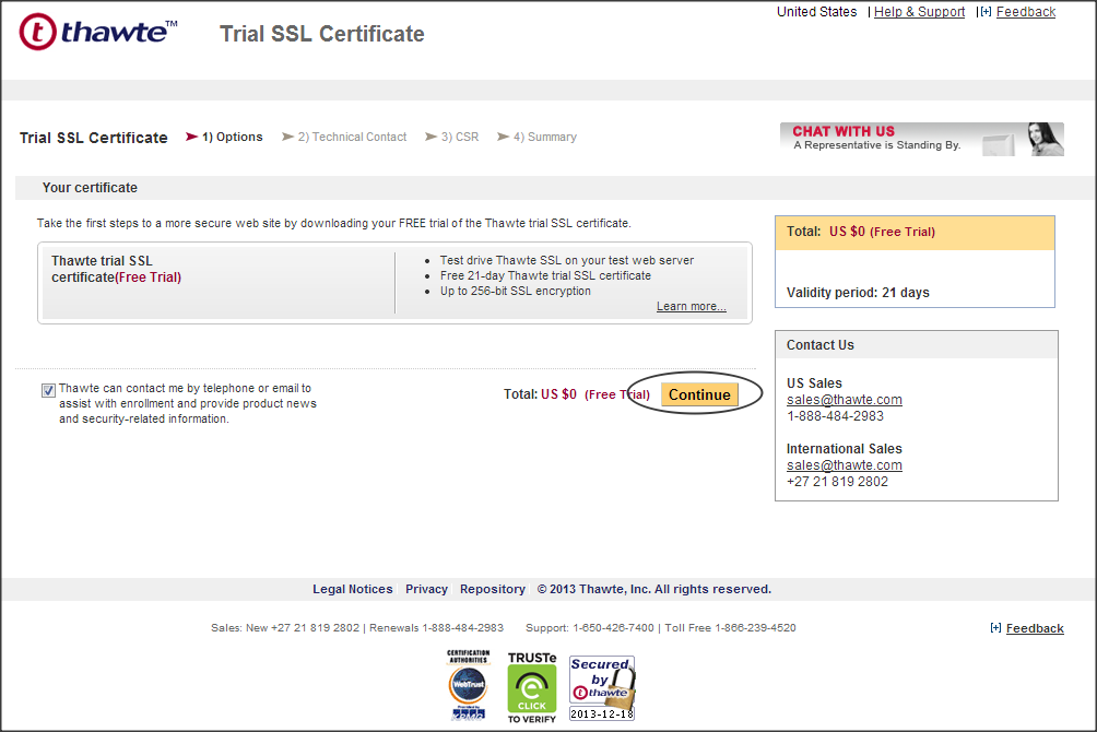

Step 3 :

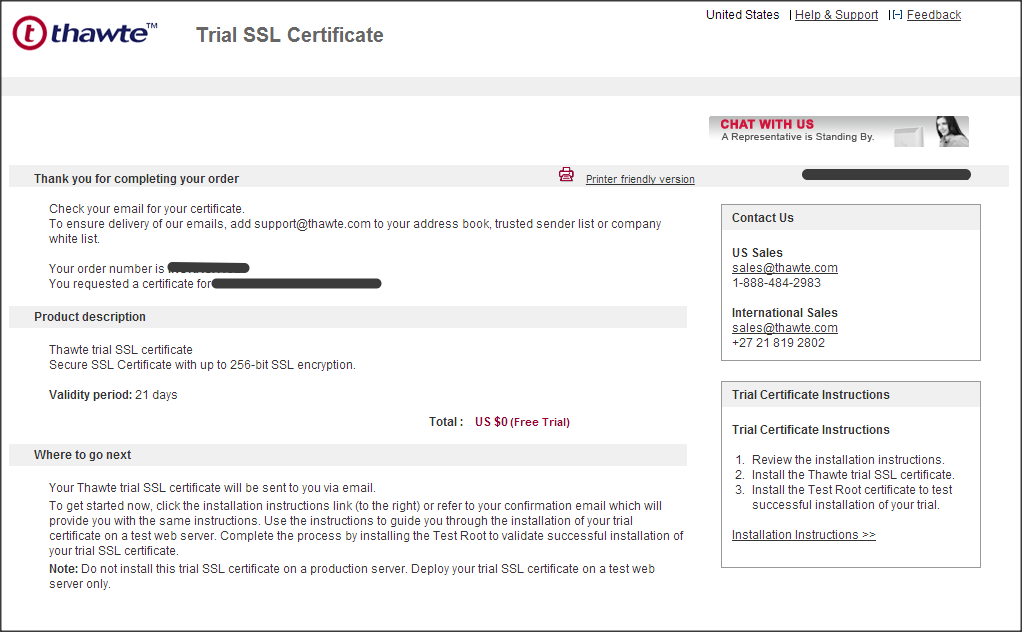

Go to your third party CA website Eg : http://www.thawte.com/
I am using a Free SSL Trial here for testing.

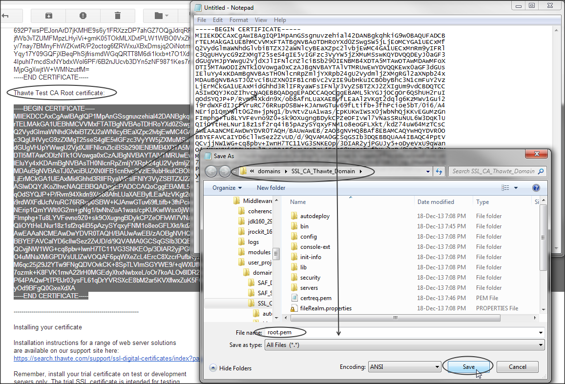

Step 4 :

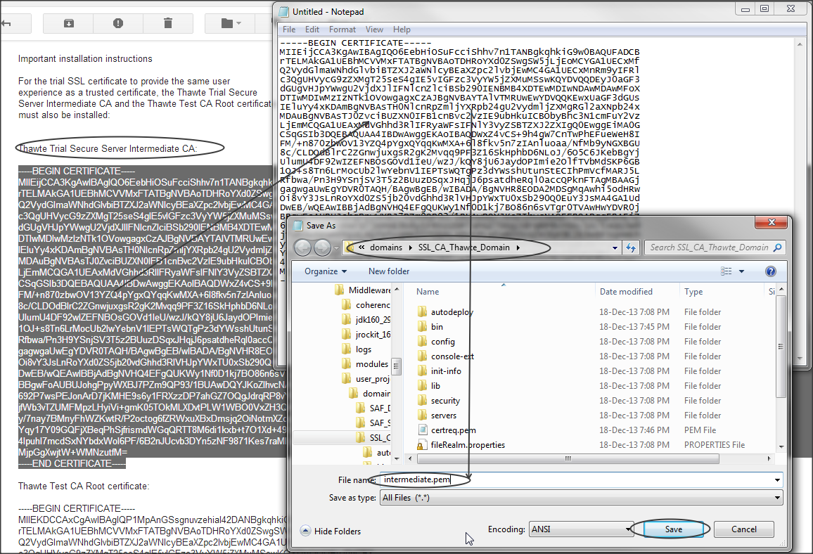

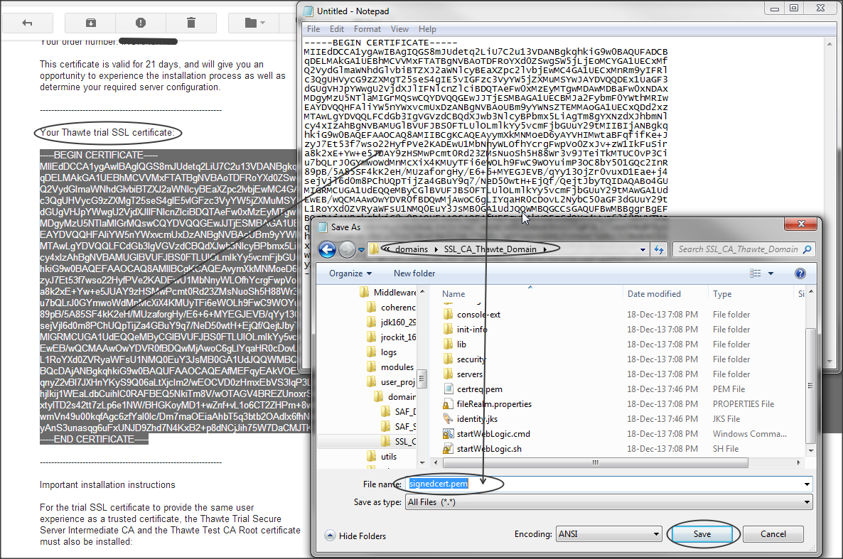

Check your inbox for an email from Thawte.
This email will contain your signed certificate , intermediate certificate and root certificate.
Copy the contents of each certificate from email and save it as a pem file as shown below :

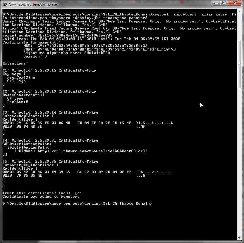

Step 5 :
Now we need to import these certificates into identity.jks keystore
– Import the intermediate certificate first –> then the root certificate –> and then the signedcert.
Command : keytool -importcert -alias inter -file intermediate.pem -keystore identity.jks -storepass password
Command : keytool -importcert -alias root -file root.pem -keystore identity.jks -storepass password

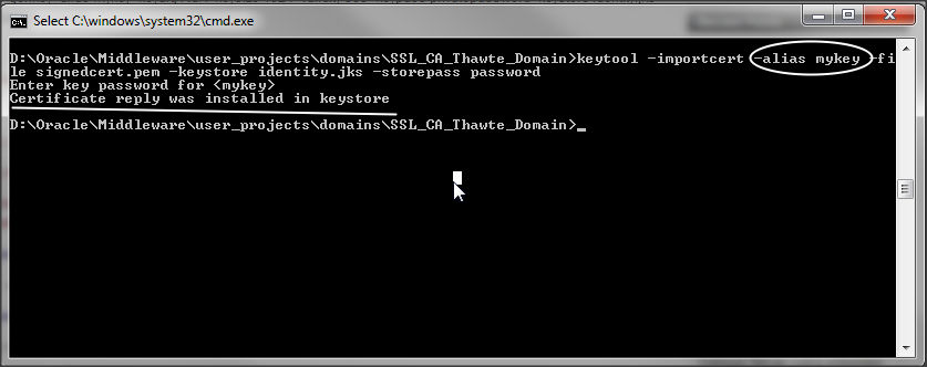

Command : keytool -importcert -alias mykey -file signedcert.pem -keystore identity.jks -storepass password
Note :
– The intermediate and root certificate should have different alias name, but the signed certificate should be imported with the same alias that was used while creating a certificate pair.
– After importing all three certificates you should see : ” Certificate reply was installed in keystore ” message.

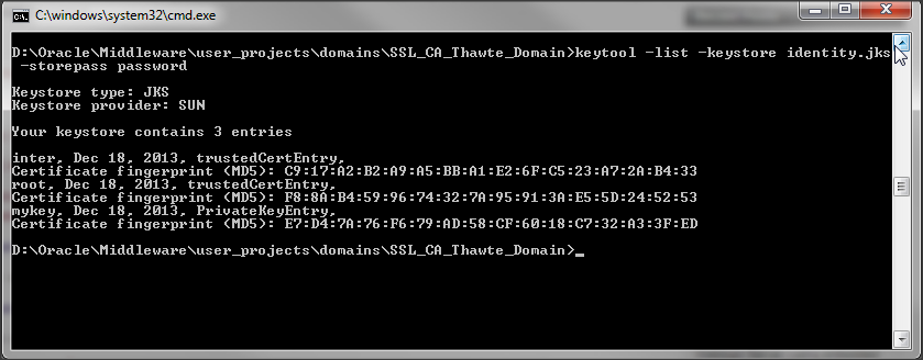

Now list the keystore and check if all the certificates are imported successfully.
Command :  keytool -list -keystore identity.jks -storepass password
To get a detailed out put :
Command : keytool -list -v -keystore identity.jks -storepass password
Note :
Check for the following in the detailed output :
Alias name: mykey
Entry type: PrivateKeyEntry
Certificate chain length: 3

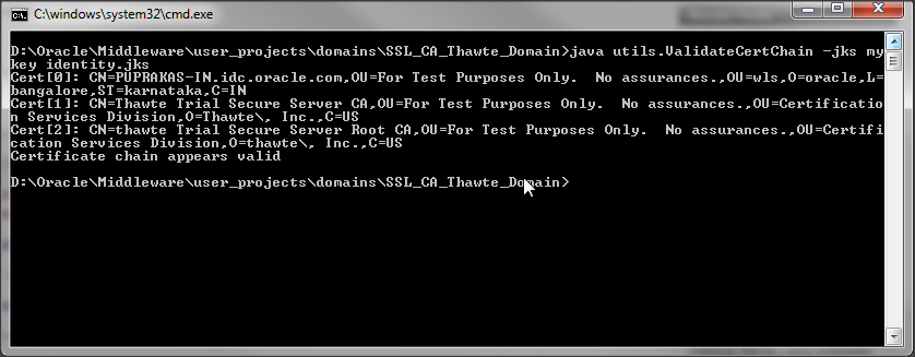

Run the following command to check if the certificate chain is valid.
Syntax : java utils.ValidateCertChain -jks <alias> <identity_keystore>
Command :  java utils.ValidateCertChain -jks mykey identity.jks

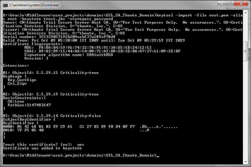

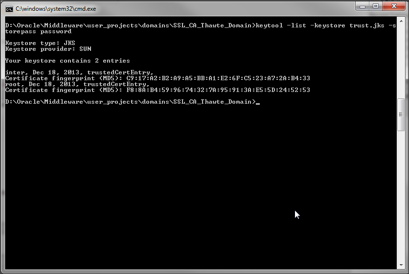

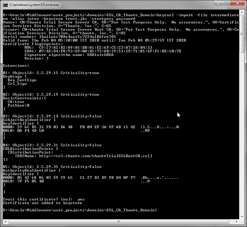

Lets create a trust keystore now.
Command :  keytool -import -file intermediate.pem -alias inter -keystore trust.jks -storepass password
Command : keytool -import -file root.pem -alias root -keystore trust.jks -storepass password
Now that we have successfully created a third party CA signed Identity keystore and a Trust keystore, we can configure WLS to use it by configuring Custom Identity and Custom Trust.
