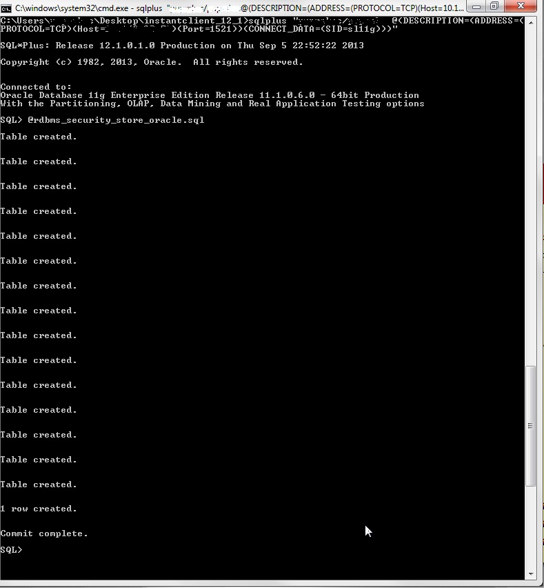

To connect to a remote Oracle Database I used the following command :
 – cd C:\Users\puneeth\Desktop\instantclient_12_1
–  sqlplus “puneeth/puneeth@(DESCRIPTION=(ADDRESS=(PROTOCOL=TCP)(Host=xx.xxx.xx.xx)(Port=1521))(CONNECT_DATA=(SID=oracle11g)))”
–  Once it is connected successfully you would see the following prompt ” SQL> “
< Additional Info >
Link : http://docs.oracle.com/html/B10131_02/post_install.htm
– Now you need to create the database tables using the sample script ( rdbms_security_store_oracle.sql ) provided in your <wlserver_10.3>/server/lib
– To run the script I used the following command :
SQL> @rdbms_security_store_oracle.sql
Now we have created a table for RDBMS store using the Oracle user ” puneeth ” — This can be used as an RDBMS store for one of the domains, say IDP.

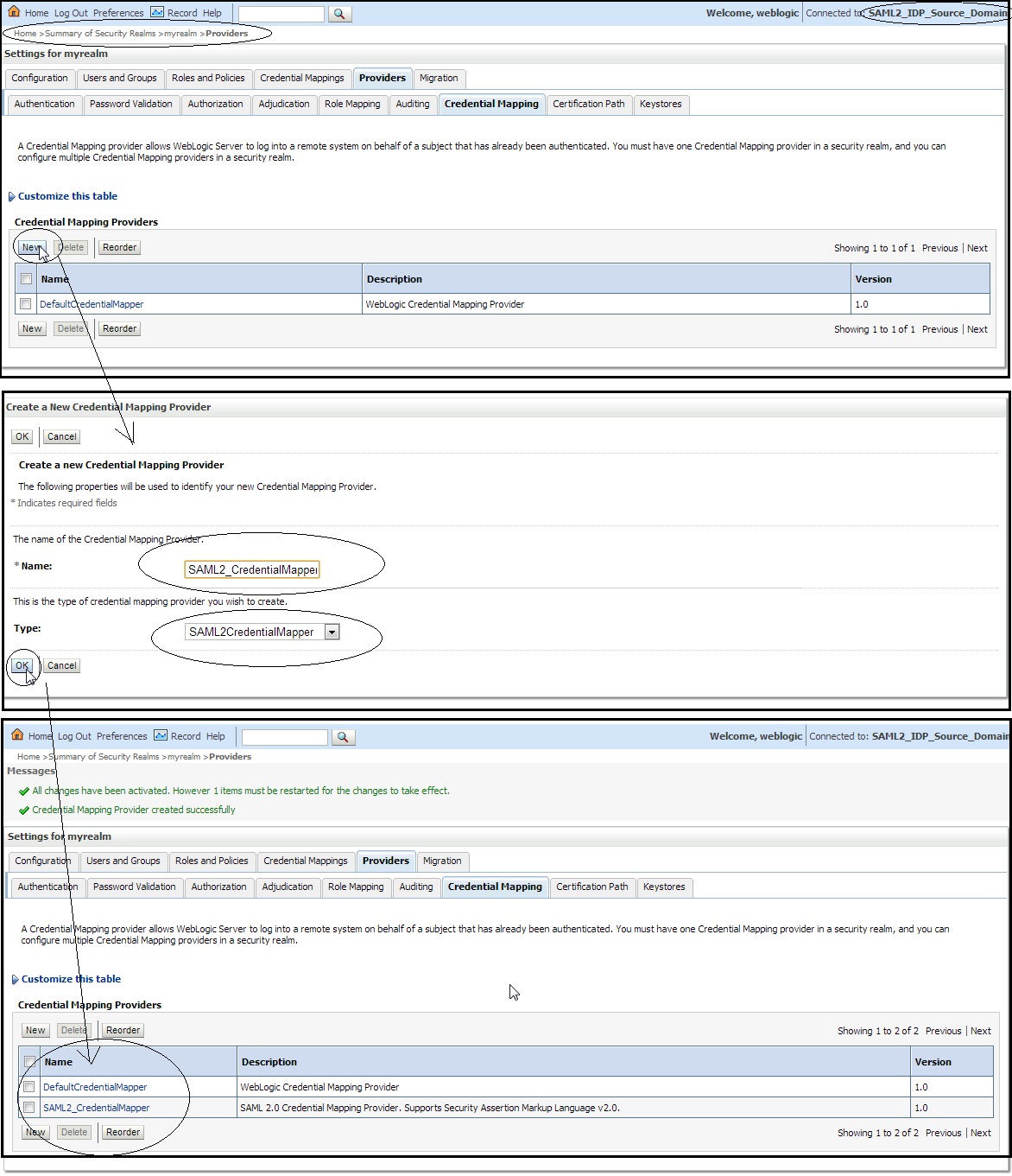

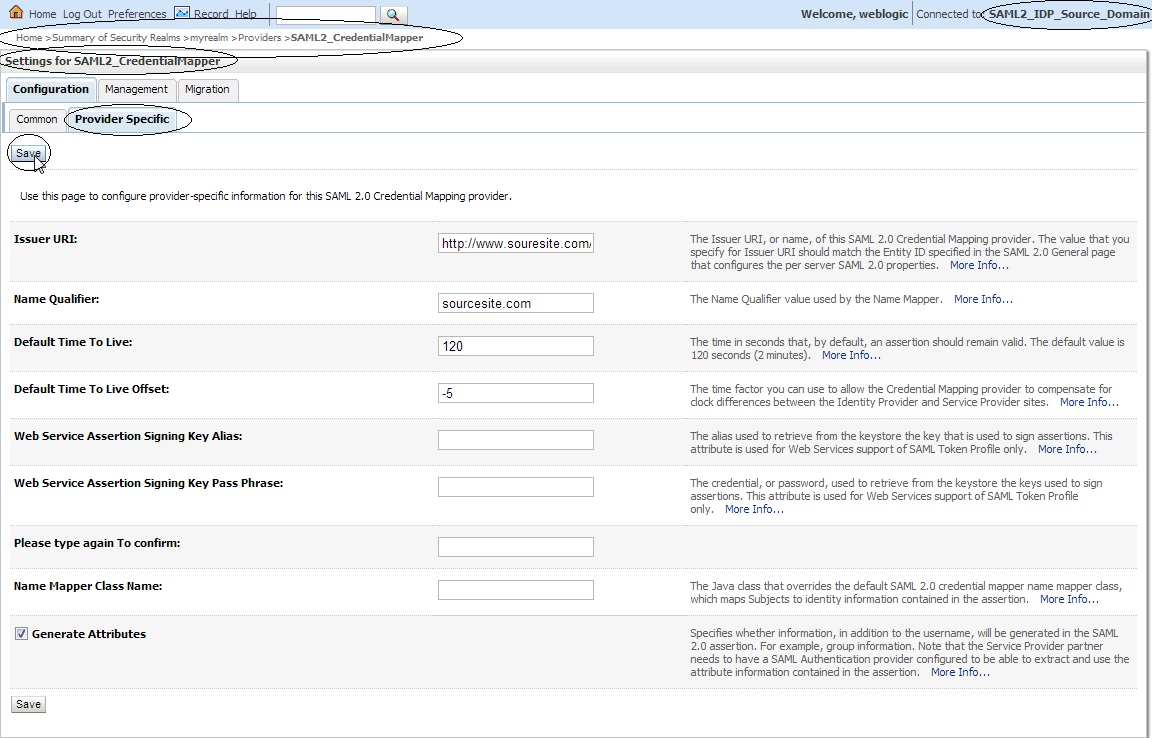

– Create a ” Credential Mapper ” on Weblogic Source domain, i.e on the IDP end.
– Login to Source domain – Weblogic console –> Click on ” myrealm ” –> ” Providers ” –> ” Credential Mapping ” –> and add a ” SAML2CredentialMapper ” say ” SAML2_CredentialMapper ” as shown below :
Credential Mapper
– Now click on the newly created SAML2CredentialMapper say ” SAML2_CredentialMapper ” and make the following changes :
“>Issuer URI : http://www.souresite.com/saml
Name Qualifier : sourcesite.com

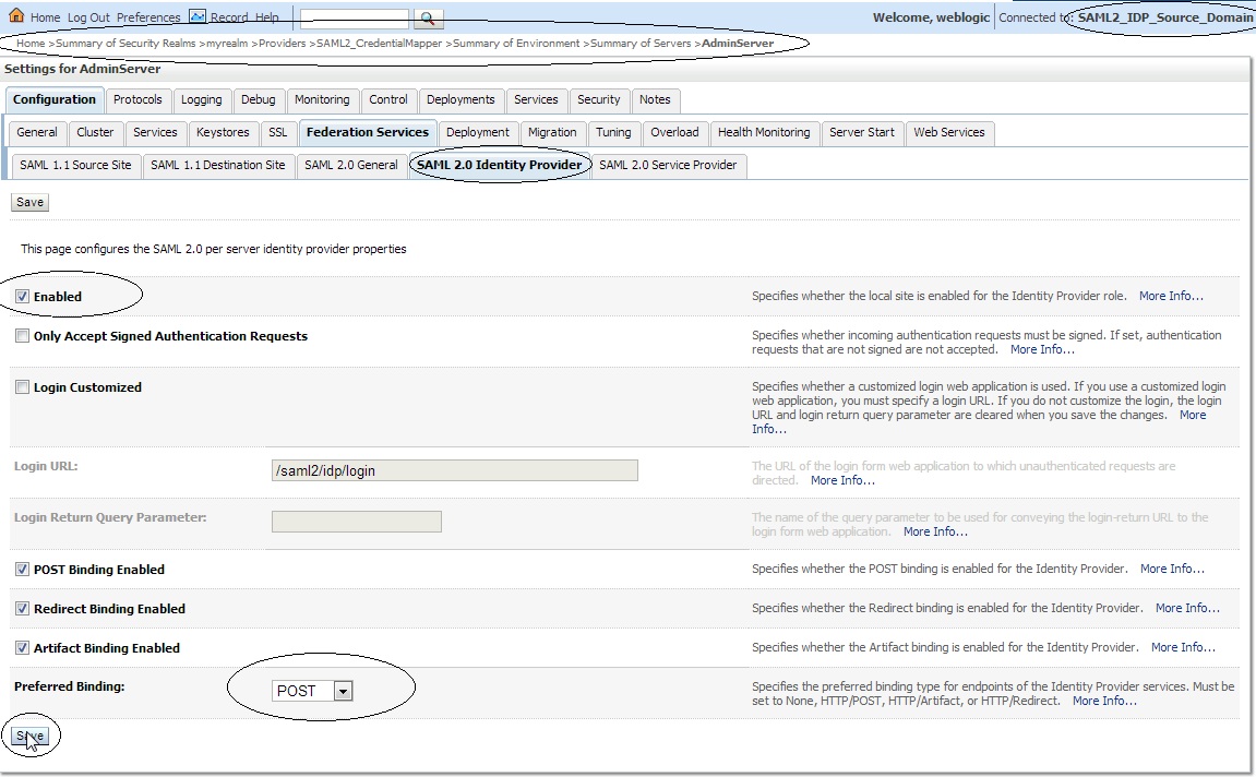

– Click on ” Servers ” –> Admin Server –> ” Federation Services ” –> ” SAML 2.0 Identity Provider ” and make the following changes :
Enabled : check
Preferred Binding : POST

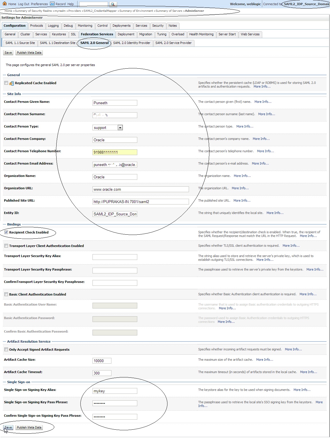

– Click on ” Servers ” –> Admin Server –> ” Federation Services ” –> ” SAML 2.0 General ” and make the following changes :
Replicated Cache Enabled – Uncheck / Check
Contact Person Given Name
Contact Person Surname
Contact Person Type
Contact Person Company
Contact Person Telephone Number
Contact Person Email Address
Organization Name
Organization URL
Published Site URL : http://<SourceSiteDNSName>:<PORT>/saml2
Entity ID : ( Source Domain name)
Single Sign-on Signing Key Alias
Single Sign-on Signing Key Pass Phrase
Confirm Single Sign-on Signing Key Pass Phrase

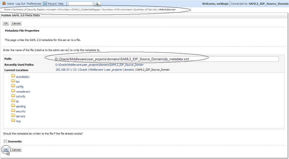

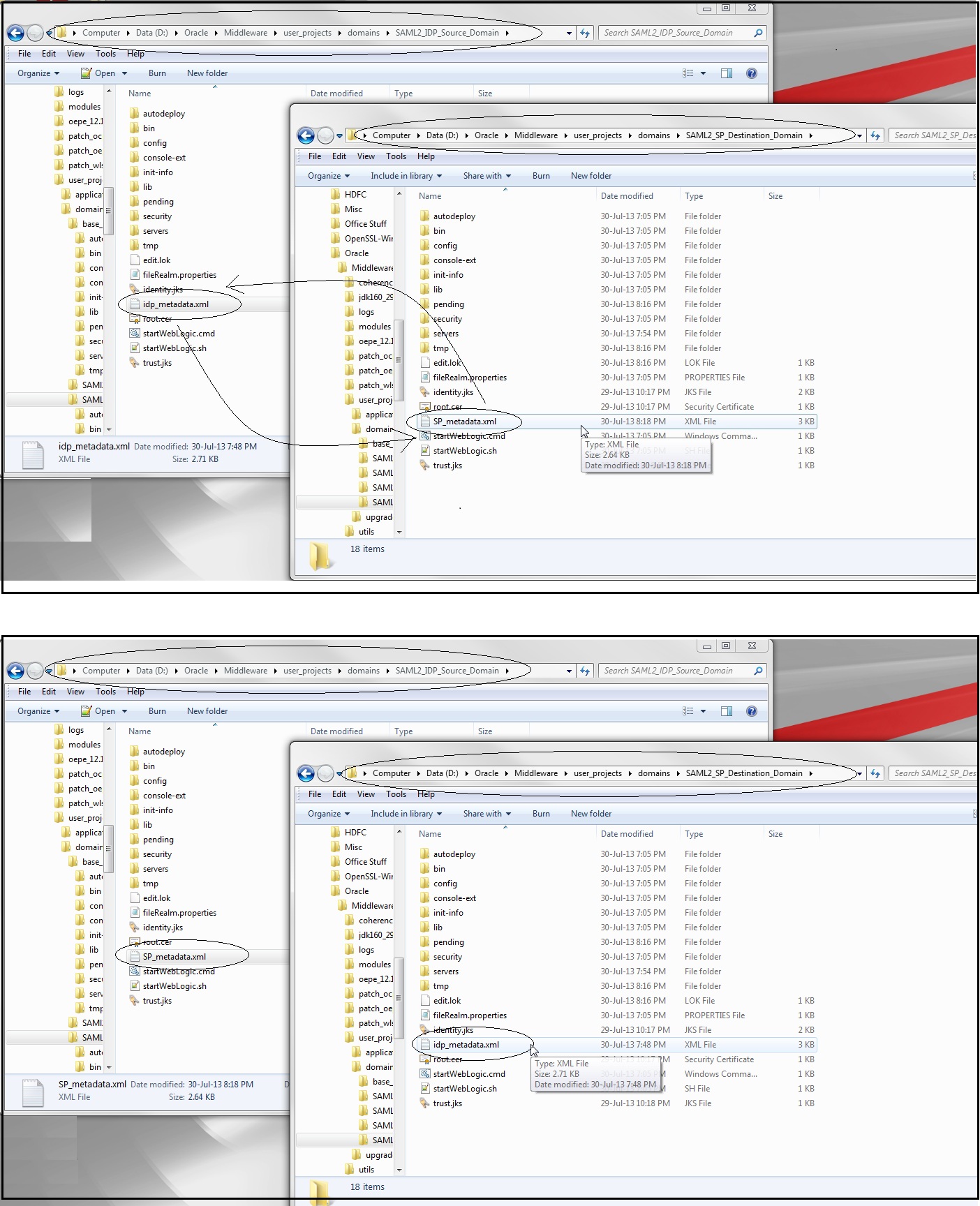

Save the changes and export the IDP metadata into a XML file –> Click on “ Publish Meta Data ” button. ( say idp_metadata.xml ). We need to copy this file to the destination domain later.

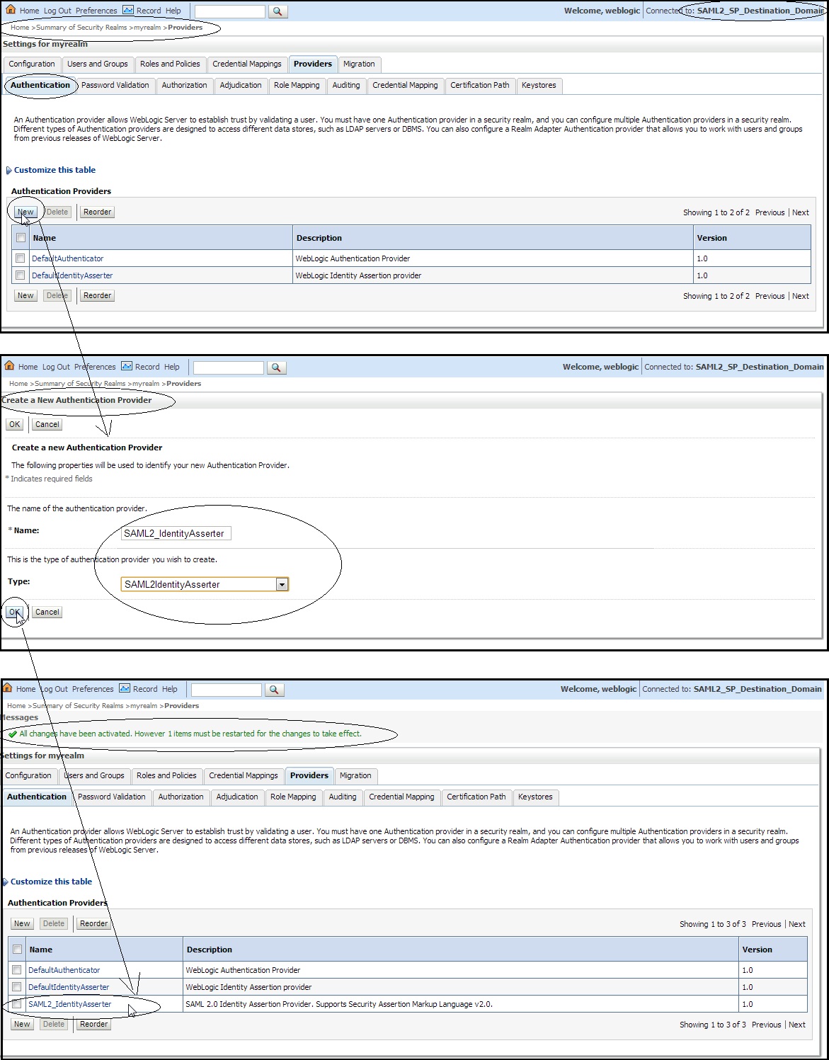

– Create an Identity Asserter on the destination domain, i.e SP end.
– Login to Destination domain – Weblogic console –> Click on ” myrealm ” –> ” Providers ” –> ” Authentication ” –> new ” SAML2IdentityAsserter “ say ” SAML2_IdentityAsserter :

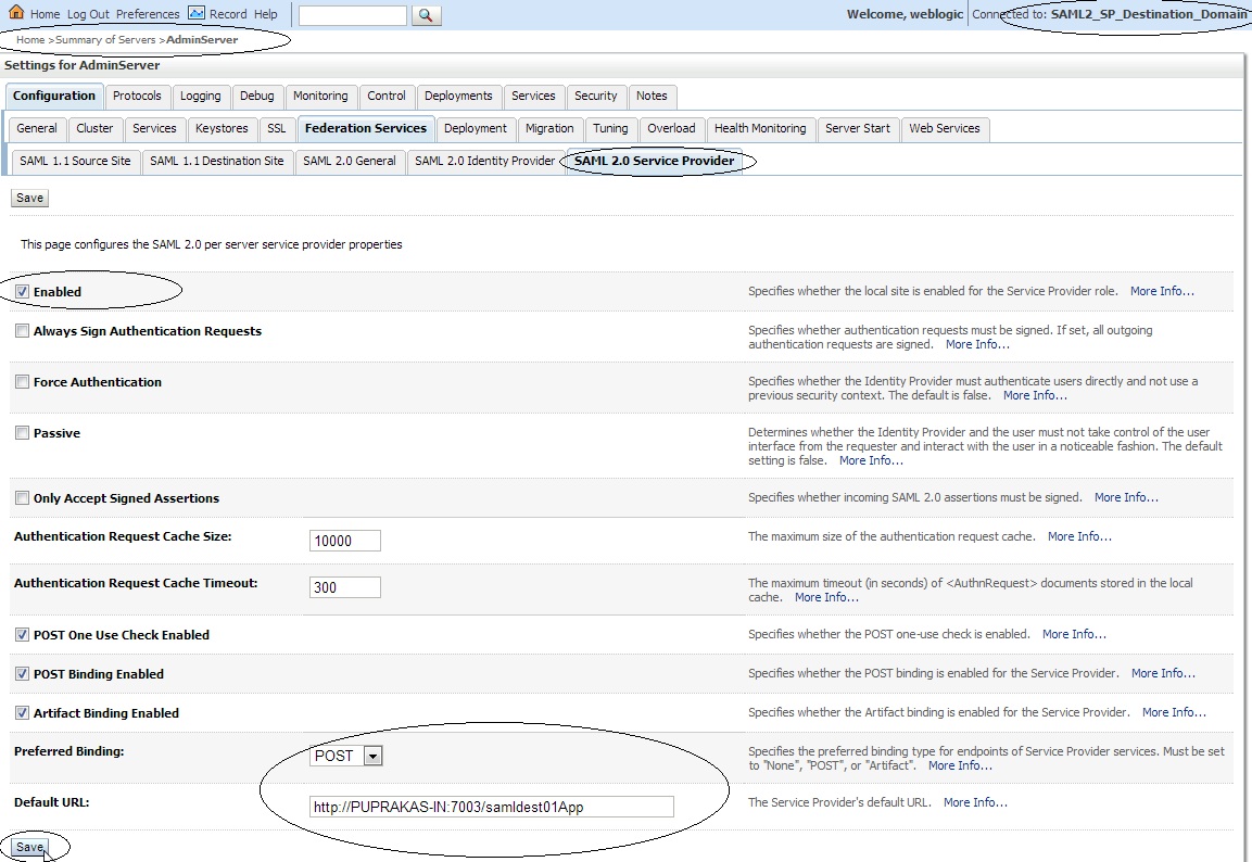

Click on ” Servers ” –> Admin Server –> ” Federation Services ” –> ” SAML 2.0 Service Provider ” and make the following changes :
Enabled : check
Default URL : http://<DestinationSiteDNSName>:<PORT>/samldest01App

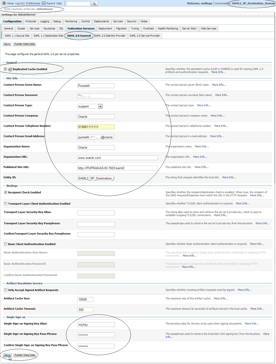

Now click on ” Servers ” –> Admin Server –> ” Federation Services ” –> ” SAML 2.0 General ” and make the following changes :
Replicated Cache Enabled : Uncheck / Check
Contact Person Type
Organization Name
Organization URL
Published Site URL : http://<DestinationSiteDNSName>:<PORT>/saml2
Entity ID : ( Destination Domain name)

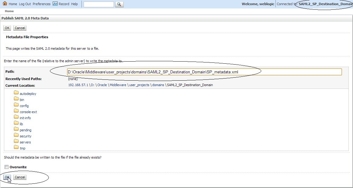

Save the changes and export the IDP metadata into a XML file –> Click on “ Publish Meta Data ” button. ( say SP_metadata.xml ).
Copy service provider metadata ( SP_metadata.xml ) to Source Domain and identity provider metadata ( idp_metadata.xml ) to the Destination Domain as shown below :

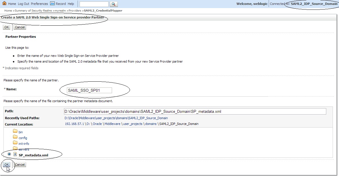

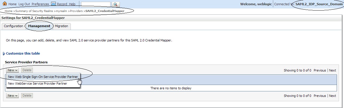

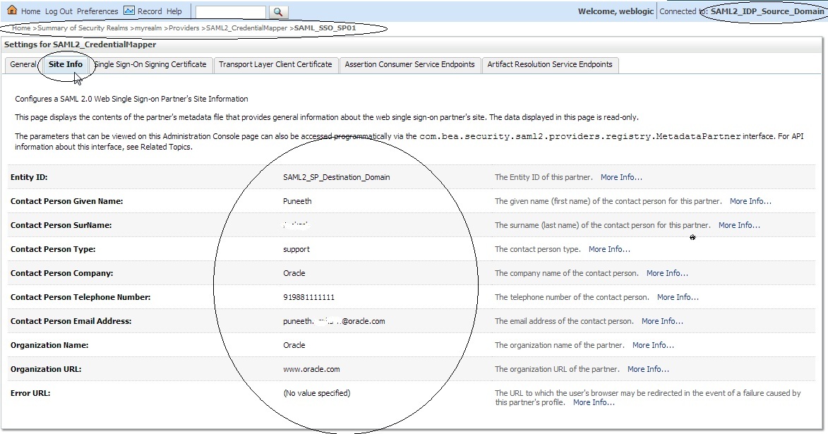

Now configure Service Provider metadata on SAML Identity Provider in Source Site :

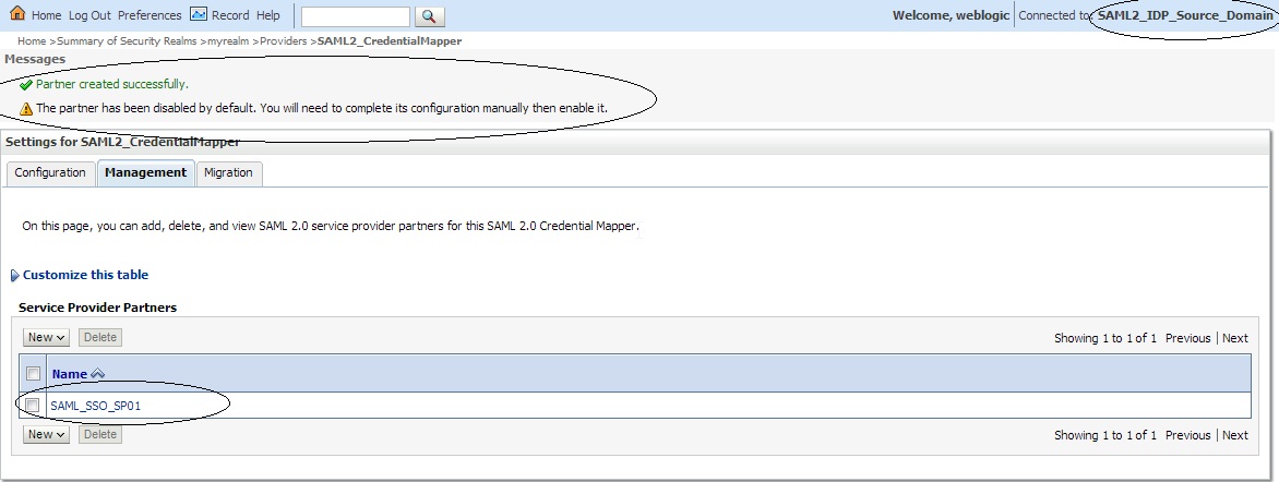

Log in to the source site Admin Console and click on ” Security Realms ” –> ” myrealm ” –> ” Providers ” –> ” Credential Mapper ”  –> ” SAML2_CredentialMapper ” –> ” Management ” –> ” New ” –> ” New Web Single Sign-On Service Provider Partner ” :
Name this ”New Web Single Sign-On Service Provider Partner” as “SAML_SSO_SP01″ and select the SP_metadata.xml file.

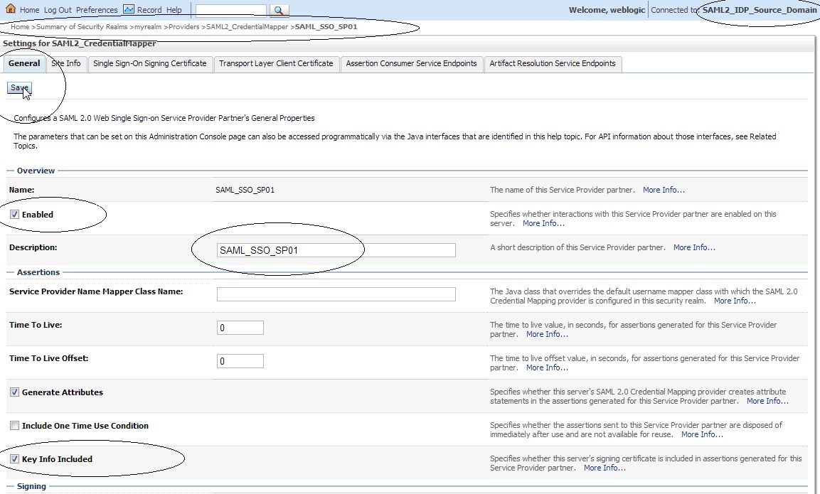

Click on the newly created ” SAML_SSO_SP01 ” and enter the following :
Enabled :  Checked
Description  : SAML_SSO_SP01
Key Info Included  : Check
Click on Site info and verify the data :

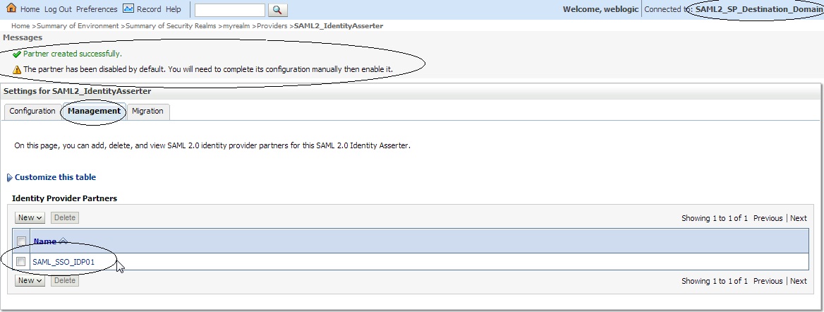

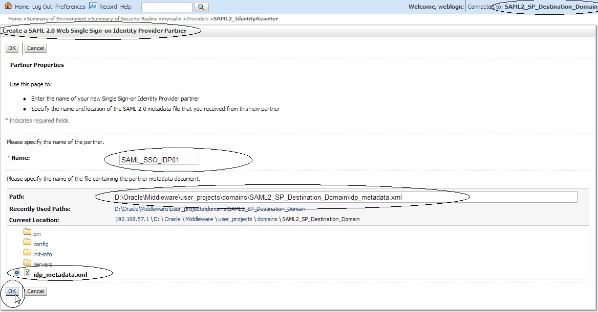

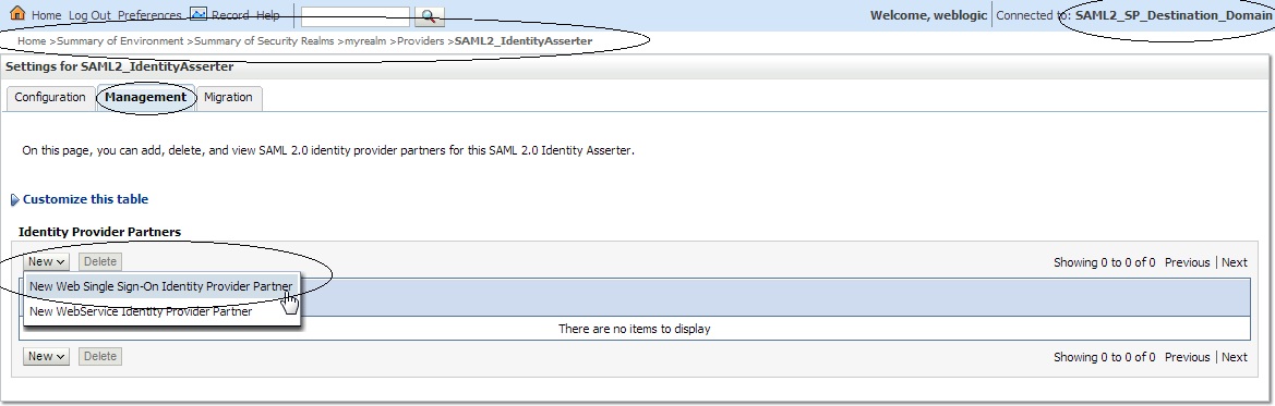

Now configure Identity Provider metadata on SAML Service Provider in Destination site :
Login to Destination Site Admin Console :

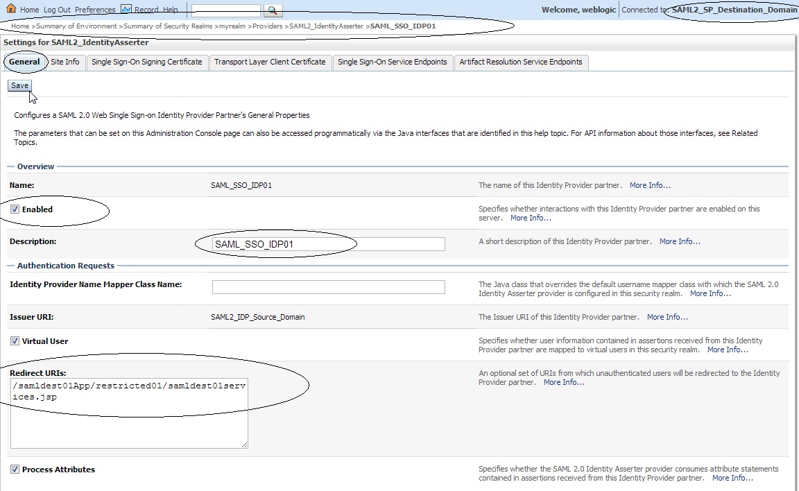

Click on ” Security Realms ” –> ” myrealm ” –> ” Providers ” –> Authentication -> SAML2_IdentityAsserter –> ” Management ” –> ” New ” –> “ New Web Single Sign-On Identity Provider Partner ” say ” SAML_SSO_IDP01 ” and then select ” idp_metadata.xml ” :
Click on ” SAML_SSO_IDP01 ” and enter the following :
Enabled : Check
Description : SAML_SSO_IDP01
Redirect URIs : /samldest01App/restricted01/samldest01services.jsp
