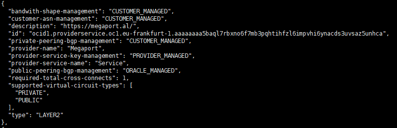

I have set up OCI CLI on a Linux Virtual Machine, as described in the documentation. I also hardcoded the region Frankfurt in my profile. The command we need to run is:
oci network fast-connect-provider-service list --compartment-id ocid1.compartment.oc1..aaaaaaaalk7vovaqsqaskshz33zpodwsdsx73hyfwmp6vataslwgq4fkajia
The compartment can be root or the actual compartment of the tenancy in which you will deploy the Virtual Circuit. The output of that command will give you details on all partners in that region. I went through the list and found Megaport:
megaport
As you can see, the output also gives us the ID which we will use in the Terraform code:
"id": "ocid1.providerservice.oc1.eu-frankfurt-1.aaaaaaaa5baql7rbxno6f7mb3pqhtihfzl6impvhi6ynacds3uvsaz5unhca"

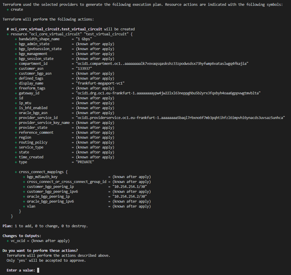

Step 2 – Setting up the code
I created a simple code to deploy the Virtual Circuit. Note that some parameters I input directly and some are declared as variables.
code
Let’s run through the code:
  • I provide the compartment for the Virtual Circuit
  • The connection type will be PRIVATE. OCI supports both Private and Public Peerings but we will use private for this demo
  • I want the allocated bandwidth to be 1 Gbps
  • I provide BGP details (Peer IPs, the client ASN, Oracle’s side will always be 31898 for the Commercial Cloud)
  • I give it a name
  • I provide the provider service ID which we worked hard to get
  • I provide the DRG’s OCID
  • I also request the resulting OCID of the Virtual Circuit because I need that on the Partner’s Website

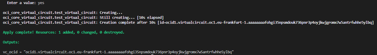

 Step 3 – Let’s apply the code
tfapply
tfapply2
As you can see, it only took 10s and the VC was created. We need the OCID from the output to input in the Partners’s website.
