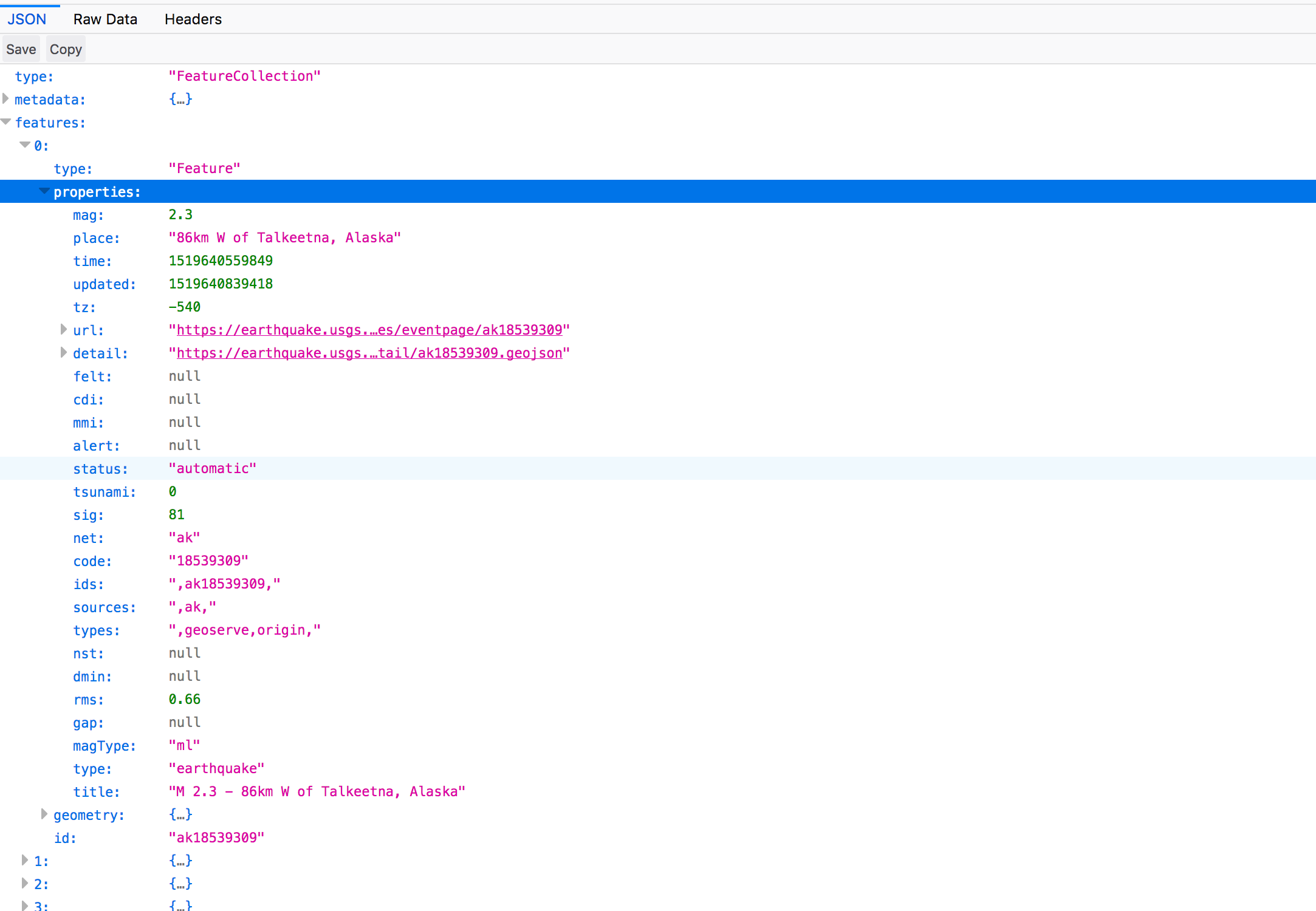

Depending on the URL being invoked, the JSON contains earthquakes for a day, a week or a month. The JSON document structure is outlined in the screen shot below. The features attribute is an array – each element contains data for one earthquake.
