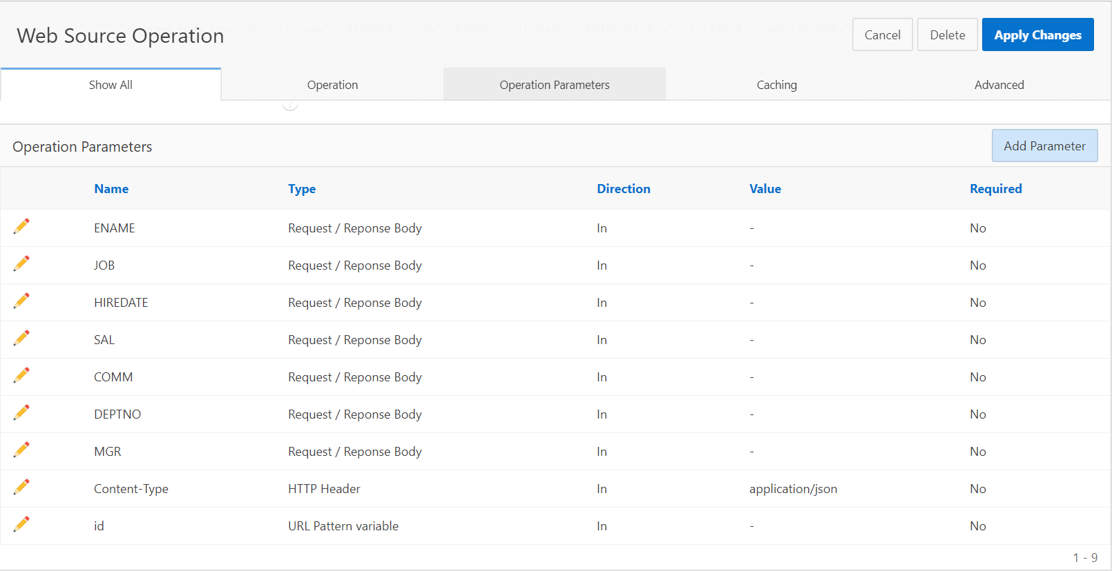

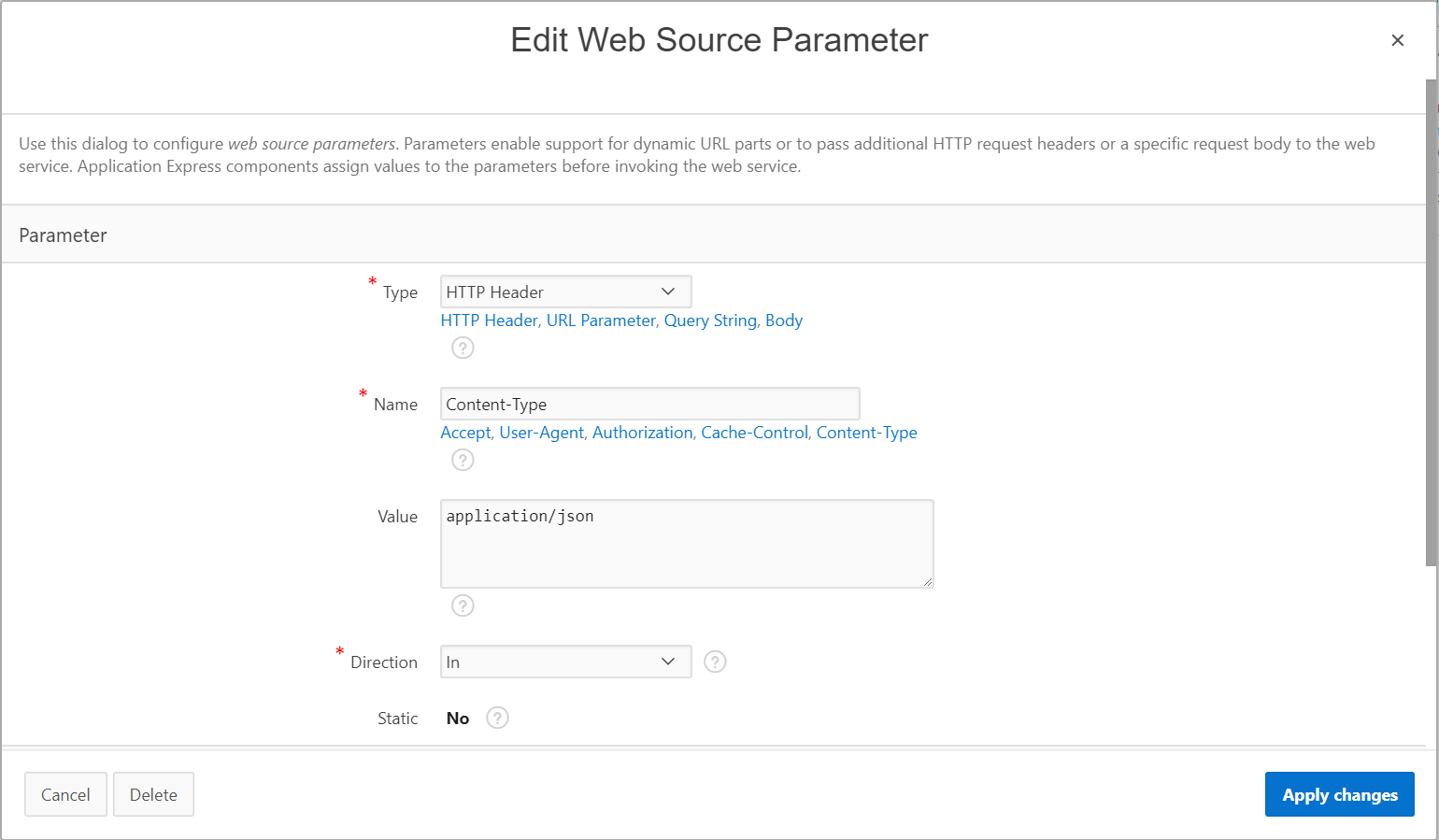

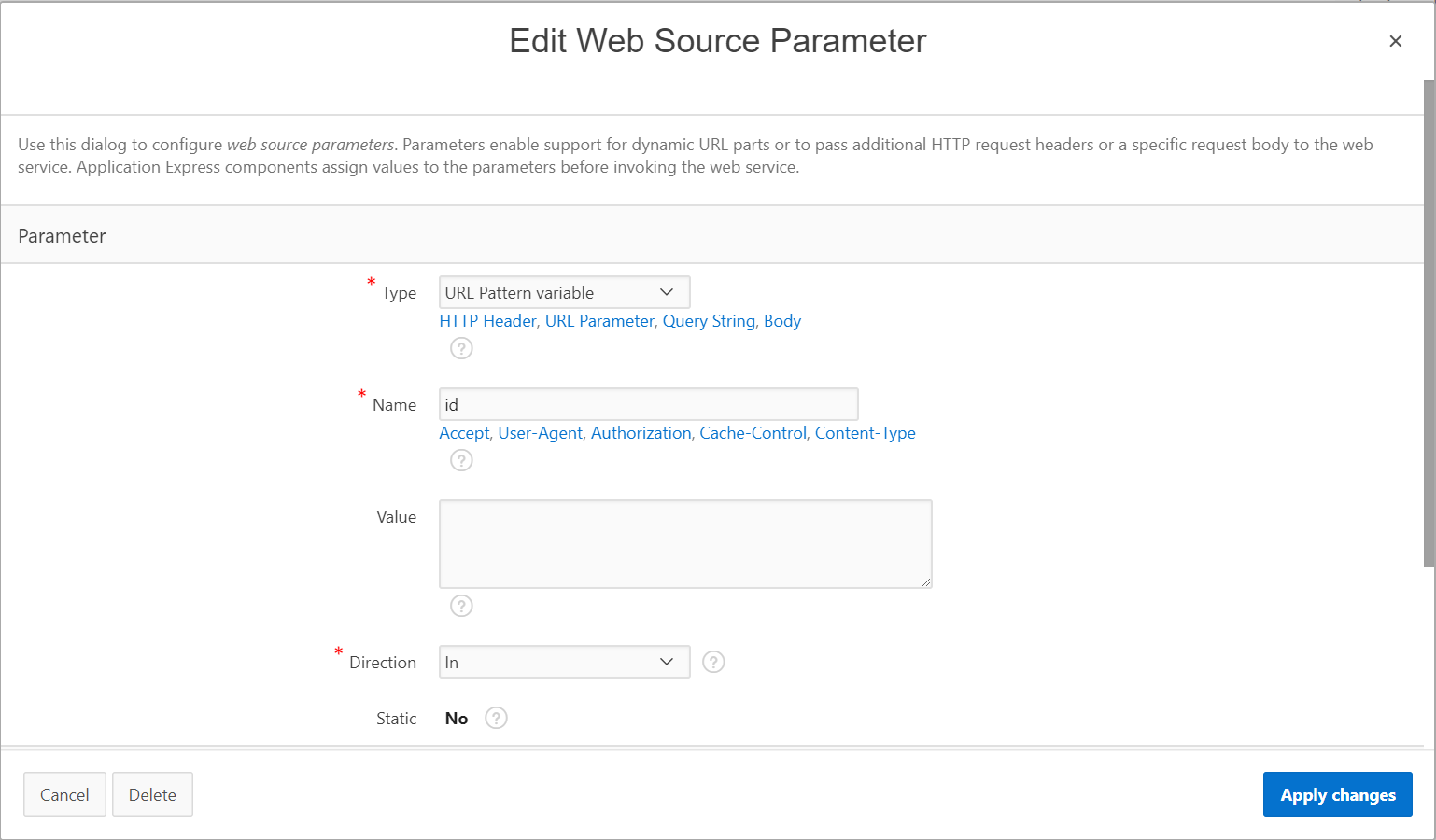

Then create one additional parameter named Content-Type, use application/json as its Value and HTTP Header as Type. Set the Static switch to No for this parameter.
The last parameter for the PUT operation will be a URL Pattern variable parameter named id.
Once finished, you should see 9 web source operation parameters, as follows. Click the Apply Changes button, when done.

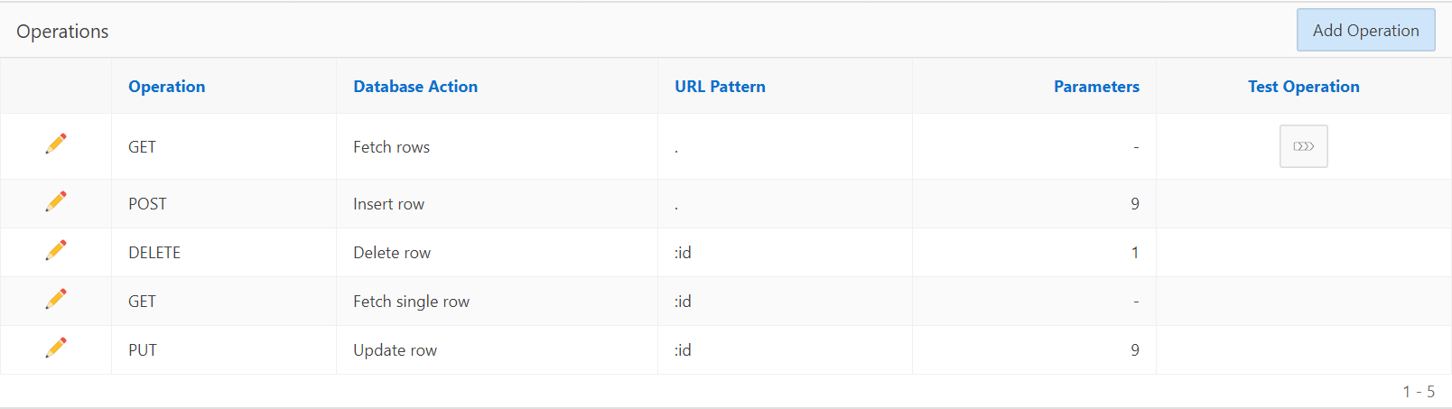

Changes to the DELETE operation

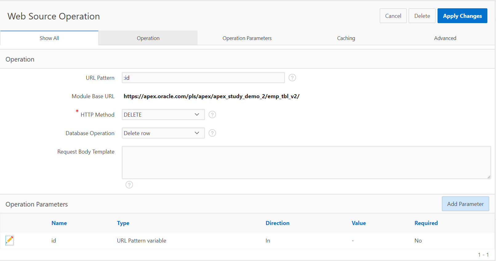

For the DELETE operation the Request Body Template must remain empty, and we need only one web source operation parameter: Create a parameter of type URL Pattern Variable, named id.
The definition of the DELETE Web Source operation should look as follows. Click the Apply Changes button, when done.
The list of Web Source Operations should look like the following screenshot. Now all Web Source operations are configured.

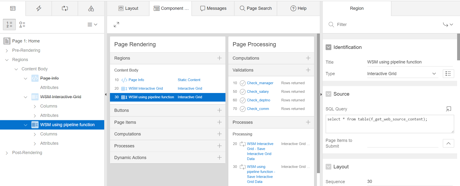

Create the Interactive Grid region
Now navigate back to the Application Builder, select your application and open page designer for the page with the Interactive Grid. If you don’t have a page with an Interactive Grid yet, create a new blank page and add an Interactive Grid region. Use the following SQL Query as the Interactive Grid region source:
select * from table(f_get_web_source_content)

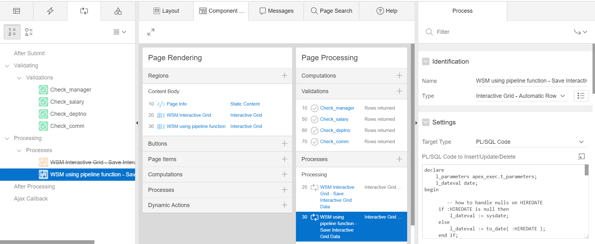

Now we need to change the Page Process (which saves Interactive Grid changes to the underlying data source). By default, Interactive Grid executes a SQL DML operation on the Region Source SQL Query. We will use custom PL/SQL code invoking the POST, PUT or DELETE REST methods.
First, make sure, that Editing is enabled for your Interactive Grid. Then navigate to the page processing section and look up the Interactive Grid – Automatic Row Processing process. For this process, change the Target Type to PL/SQL Code. Turn off Lost Update Detection and set Lock Row to No.
Then add the following PL/SQL code. This code handles all INSERT, UPDATE and DELETE DML and will execute the POST, PUT and DELETE Web Source Operations accordingly.

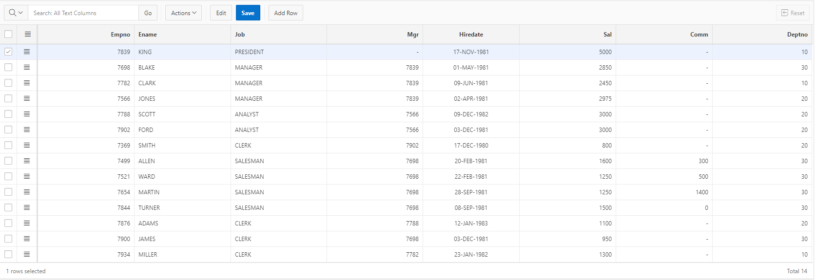

When done, save and run your page. The Interactive Grid fetches the data from the REST service – using the f_get_web_source_content table function.
You can change values, add and delete rows. When the Save button is clicked, the PL/SQL Interactive Grid process will invoke the required REST service methods.
After Delete
