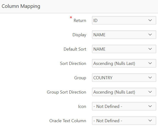

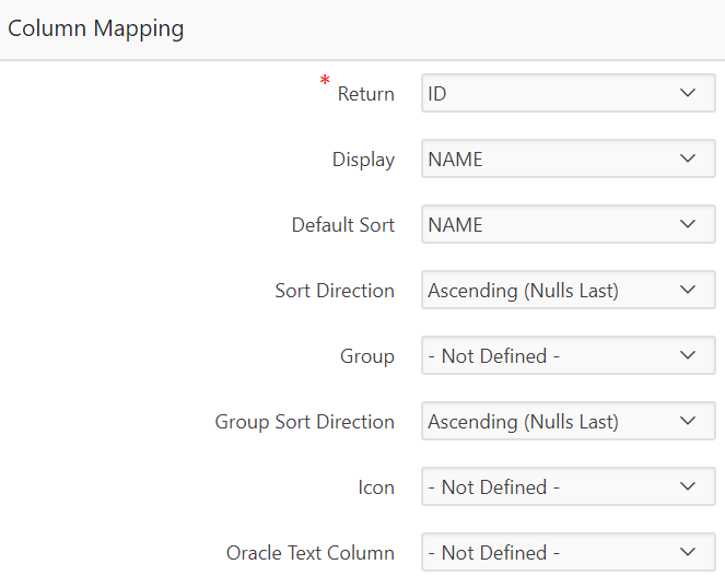

Creating the Needed List of Values
There are four lists of values that can be useful in Faceted Search Page and Orders Page, following the details:
  1. SALES_REP_LOV: A dynamic list of values based on the S_EMP table. This LOV is already created and customized.
  2. S_CUSTOMER.NAME: A dynamic list of values based on the S_CUSTOMER table.

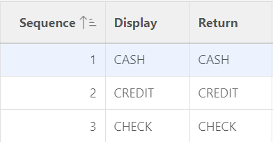

3. S_ORD.PAYMENT_TYPE: A static list of values using the following values.
4. S_PRODUCT.NAME: A dynamic list of values based on the S_PRODUCT table.

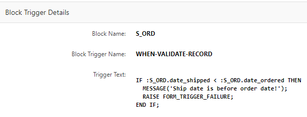

Using this form, end-users can create, update or delete an order. Before creating/updating an order it’s important to validate the entered information. Let’s track the triggers in the Migration Project and add the required validations.
Creating Validations
WHEN-VALIDATE-RECORD
To create this validation in the Orders Form:
  1. In the first pane, go to the Processing tab.
  2. Right-click Validations and select Create Validation.
  3. For the Name of the validation, enter Validate Order Dates.
    For Type, select SQL Expression.
    For SQL Expression, enter :PX_DATE_SHIPPED > :PX_DATE_ORDERED.
    For Error Message, enter Ship date is before order date!
    For Associated Item, enter PX_DATE_SHIPPED.
  4. Click Save.

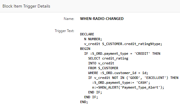

WHEN-RADIO-CHANGED
For this validation, you can create a procedure to validate the credit rating of the customer (preferred) or include the code in the validation.
To call a validation procedure, select the validation type: PL/SQL Function (returning Error Text) and for PL/SQL Function Body Returning Error Text enter:
DECLARE
    l_message VARCHAR2(200);
BEGIN
    Prd_validate_payment(p_customer_id => :PX_CUSTOMER_ID,
    p_payment_type => :PX_PAYMENT_TYPE, p_message => l_message);
    RETURN l_message;
END;

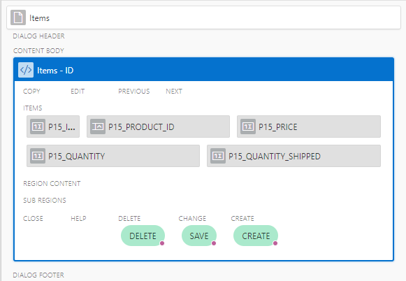

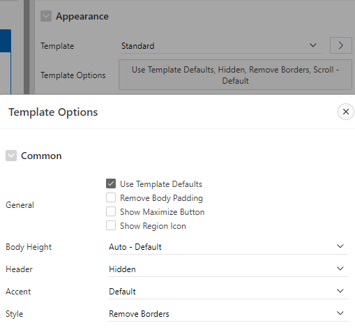

Once the page is created, let’s create the Region which contents the items:
Create a Region
  1. Find the Gallery Region at the center bottom of the page.
  2. Drag a Static Content region and drop it in the Content Body section.
  3. For Region Name, enter Items.
  4. Apply the following Template options and click Save.
Create Items
  1. Find the Items Gallery at the center bottom of the page.
  2. Drag five items and drop them in the Item Region. Ensure the following settings for each item and click Save.
Name Label Type List Of Values
PX_ITEM_ID Item Id Number Field
PX_PRODUCT_ID Product Id Popup LOV S_PRODUCT.NAME
PX_PRICE Price Number Field
PX_QUANTITY Quantity  Number Field
PX_QUANTITY_SHIPPED Quantity Shipped Number Field
PX_SEQ_ID   Hidden
PX_SEQ_ID is going to be used to manage the items in the collection when the end-user needs to edit or delete an item.

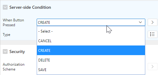

Create Buttons
  1. Find the Buttons Gallery at the bottom center of the page.
  2. Drag three buttons and drop them in the Item Region. Following the settings for each button:
Name Label Action Server-side Condition
DELETE Delete Submit Page PX_SEQ_ID is NOT NULL
SAVE Save Submit Page PX_SEQ_ID is NOT NULL
CREATE Create Submit Page PX_SEQ_ID is NULL
At the end of these steps, the Items Page will look like this: one region containing five visible items and with three buttons:

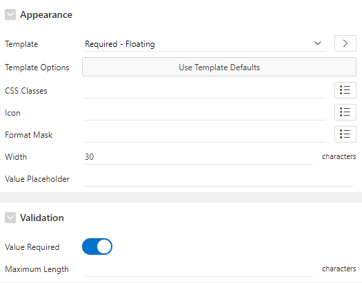

There are six required columns in the S_ITEM table, which are: ID, ORD_ID, ITEM_ID, PRODUCT_ID, PRICE, and QUANTITY. So, I need to make sure that end-users entered the data for the columns they can control. An easy way to validate that is to set two attributes for each item, following these steps:
  1. In the first pane, find the Items Region and expand the items.
  2. While holding down the Ctrl key, click the items: PX_ITEM_ID, PX_PRODUCT_ID, PX_PRICE, and PX_QUANTITY.
  3. Find the Appearance group and for Template, set them to Required – Floating.
  4. Find the Validation group and for Value Required, set them to On.
  5. Click Save.

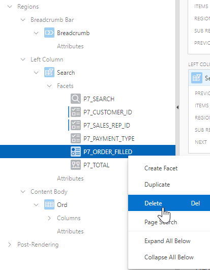

Since order filled is not a key facet search, let’s get rid of it by following the steps:
  1. Click App Builder and click your application.
  2. Go to the Faceted Search Page.
  3. In the first pane, find the Search Region.
  4. Right-click on Order Filled and select Delete.
  5. Click Save.

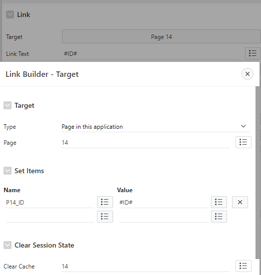

In order to manage the past orders, let’s create a link to the new Orders Form. To do so follow these steps:
  1. In the first pane, find the Ord Region.
  2. Expand the columns.
  3. Click ID Column and for type, select Link.
  4. Find the Link group and click the target attribute. Add the following:
    Page – enter the page number or page alias to navigate to.
    Set Items: Name – enter or select page items (PX_ID), application items (LAST_PAGE) or interactive report filters (IR_EMPNO) to be set into session state.
    Set Items: Value – enter or select a report column (#ID#), enter an application or page item (&P2_EMPNO.), or enter a static value (2).
    Clear Cache – enter a comma-delimited list of page numbers (2,3), items (PX_EMPNO,LAST_PAGE), and report settings to be cleared. To reset pagination for a report enter RP. To clear or reset interactive report settings enter CIR or RIR.
  5. Click Save.
